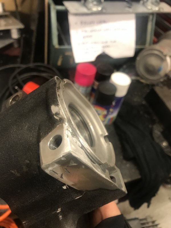

If you will make a plate as I suggested a few post up the starter will be fine, a plate that fits under both bolts will distribute the clamping force better and the small crack will not travel...
After my experience with the GM starters, I am not 100% sold on over torqueing being the issue. I never checked to seevwhat torque was used thoughSucks, ut better to know the issue. I was really wondering because between this forum and the hummer forum, probably 100 of those starters have went on in the last few years. No one had any issue anything like that, and in the last pic it is very visibly bowed from the stress. Maximum clamp force of a fastener is almost always too much. Starter is expensive but glad you didn’t do it on something like a head or main bolt.
I destroyed my last powermaster on a 6.5 in my hummer by driving over the ledge on a hill top and someone previously drove in a huge piece of rebar (concrete reinforcement metal bar) for a place to hook on a winch snatch block. My hummer weighed 8,500lbs that trip and most of the weight was on that starter. It destroyed the center section where the windings are and the aluminum nose that you broke was perfectly fine on mine. Basically the rebar stabbed through my starter. I didn’t know at the time powermaster would have rebuilt it for me.
Anyways, my point is, that aluminum part held the load of probably three tons and did not fail. And it dropped onto the rebar, not a nice smooth settling.

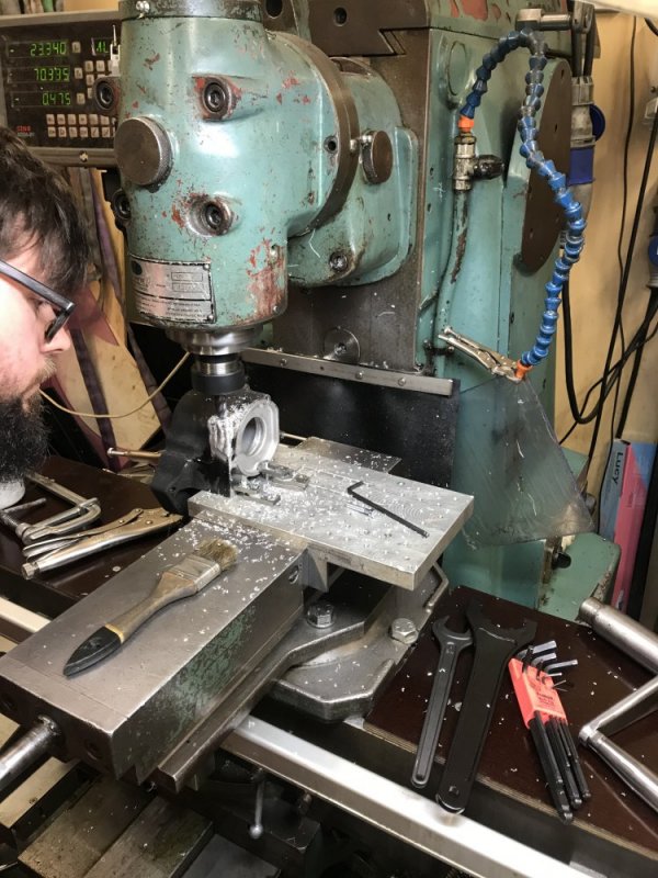

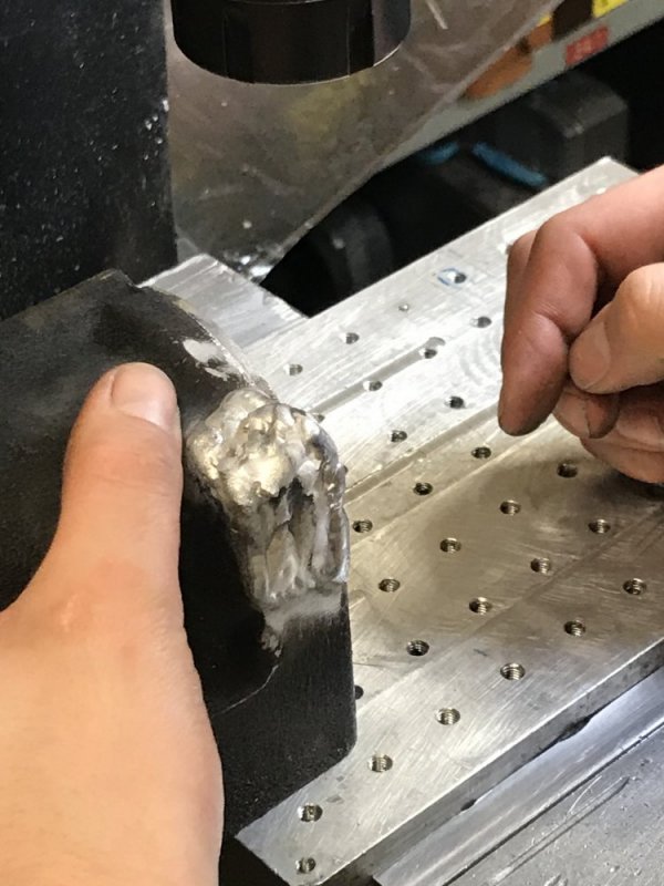

the angle iron thing is a good option, so is removing it and have it welded up. Imo the best option, since they sent you a free replacement which technically was your fault- call them one more time and buy the part explaining you discovered the error.
