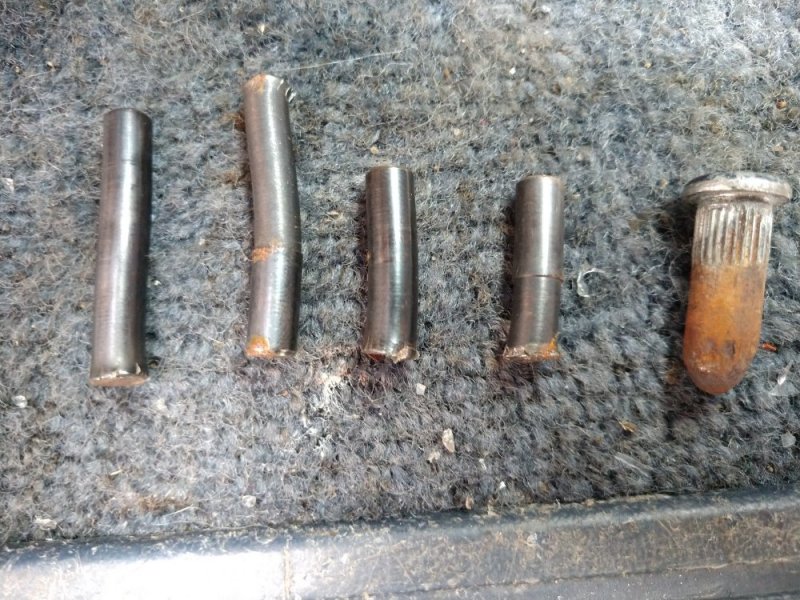

Hello group, so I have been reading about the hinge removal of the barn doors, so I purchased a pin removal tool, the pins that came with the tool are bent and unusable, I was just able to get the top one off (far right pin). I'm just wondering if it's supposed to be one piece or two?
Thanks.

So what's this pin removal tool? First time I did this job, I drilled out the pins and that was a PITA. I'm always interested in new tools, so please show and tell me where I can buy.
