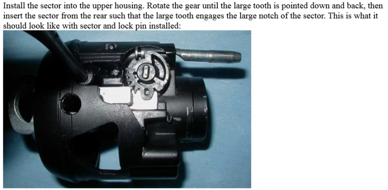

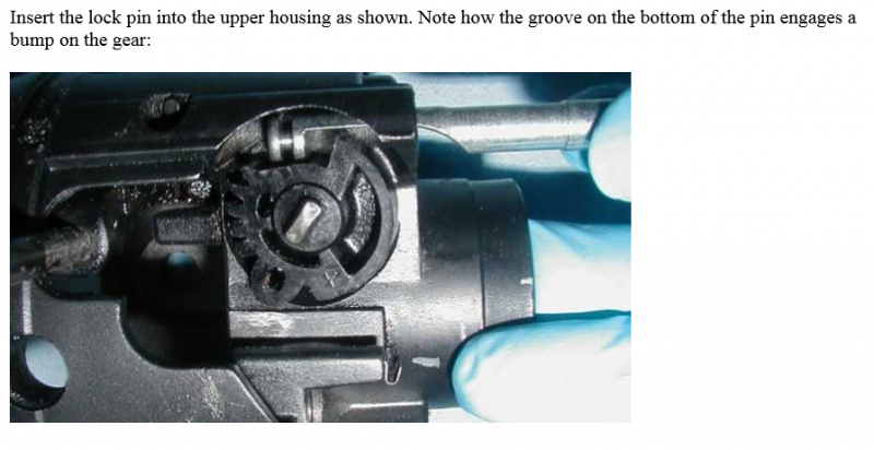

If I remember right there's like a rack and pinion deal in there with a spring loaded button that pops into a notched plate that is splined to the main column steering shaft. Maybe you got it a tooth off.

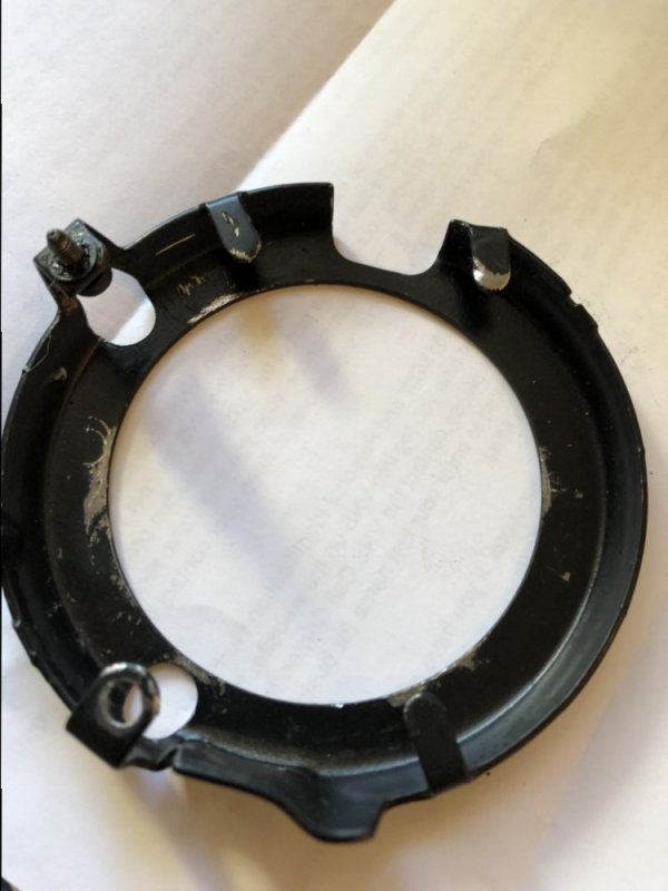

Think I found the problem. The lock pin is moving in and out with the key. However, a tab on the retainer for the lock plate was bent askew and obviously grinding (see pic). Now I just need to find similar so I can bend it pack to proper position.
