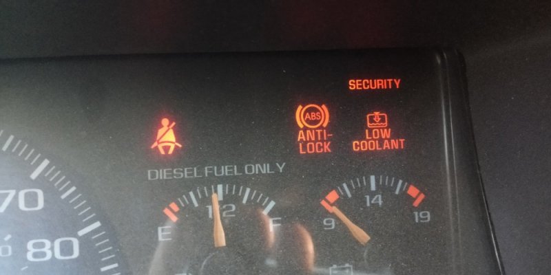

I am not sure that this truck has any kind of pass lock or security system on it. I have never seen any lights for it and, the radio had been replaced to some fancy brand that I have never figured out how to consistently operate. LOL
Should be a light at the top right corner of the dash . Should come on during bulb check unless it's been disabled in the PCM in which case you'd have a u1000 code with a good scanner
No U1000 code was ever detected, I`ve had it on an OTC genesis scanner, that scanner tool will read the injectors timing and way more stuff than I need to know. LOL I will double check for the light when I get ready to fire the truck to go to a Dr. appt in a while.
I checked the dash lights when key is first turned on, no lights mention security, I even looked for a small red light, none present, no room for any other warning lights between the ones that's already there. After I get the coolant pump and the batteries reconnected I`ll get a pic of the dash upon key being turned to run.
