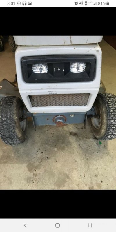

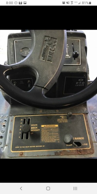

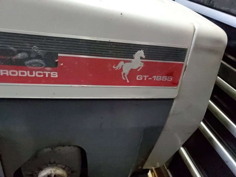

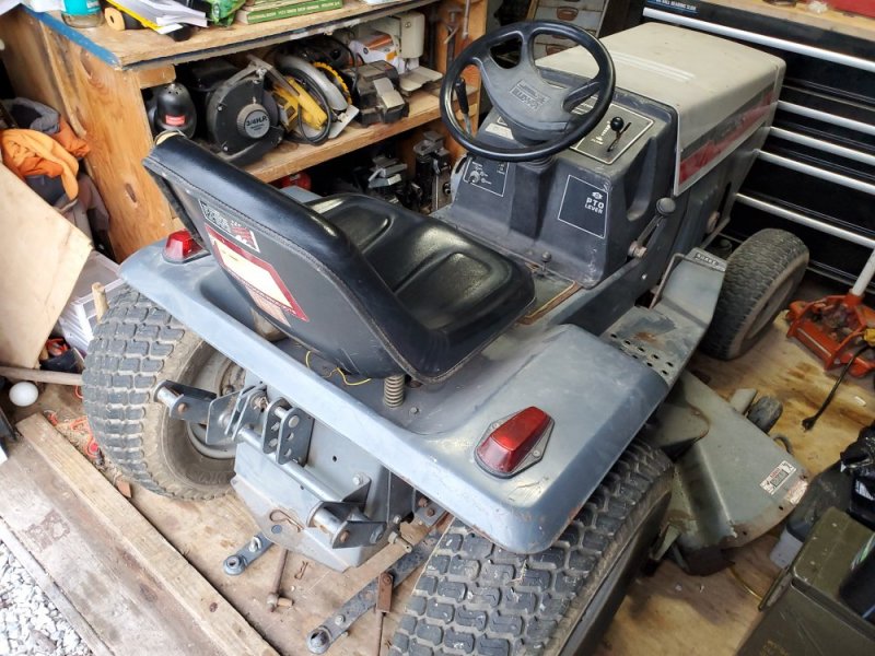

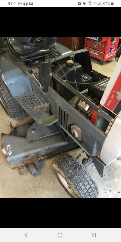

Traded the truck for a White MTD 1855 143-998-190 tractor.

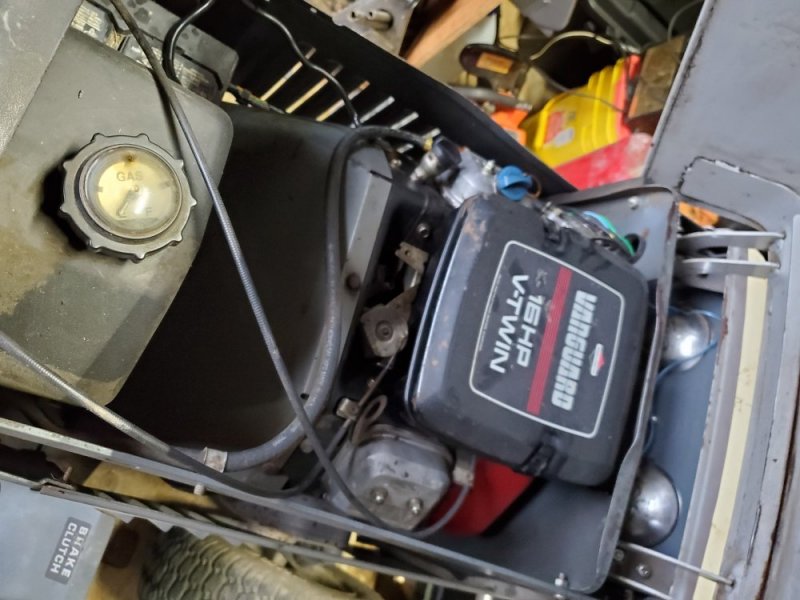

Carb is finicky, as it won't idle, and the shaft driven deck is vibrating too crazy to mow.
It has a 3 pt, cat 0, hitch. I had to remove the components to close my shed door. But all 3 pieces came with
Currently looking for atv tires and/or tire chains before I get a chance to find or make a grader box and/or blade. And a tune-up kit. What hydraulic fluid and engine oil should I use?

Get on the MTD website and register the tractor in Your equipment section. I was able to get the owners manual through their documentations.
Vibrations on deck sounds to me like the blades is whacked out of balance. I had to install new spindle/bearing housings on Mine, new belt and new blades. It sure does run fine now.

Carbs idle jets really don’t like modern fuel. When it sits a month, the ethanol evaporates and you get a “shellac” build up in the tiny ports like used to take 2 years worth of sitting using real gasoline. (Not just diesel got ruined imo by alcohol)
I cant say if B&S carbs will recover being cleaned out, but Honda, Yamaha, Kohler, and Kawasaki - ALL of them the only answer is buying a new idle jet each time. The more accurate made, the worse it affects it.
Used to be the worst thing to do is let a carburetor sit dry, now its the best option unless you can buy ethanol free gas near you.
If it runs ok in mid and upper rpm, and you checked that you dont have any vacuum leaks-redoing that carb is likely in the future.

The tractor came with no air filter and was told by PO that it's actually an 18 hp motor but he couldn't find a cap for it and the 16hp air filter cap fit.
Regardless - it appears Amazon sells a kit that fits 12.5-20hp motors - Vanguard & B&S. If I can't find something at Rural King, than I'll get that kit. (This project falls after cleaning my shed, so not in a big hurry with the shut down still in effect.)

I installed a new air filter and it seems to have settled the rough idle a little bit (had no air filter before). But, I still plan on doing an oil change, fuel filter change, and clean the carb one way or another - may just spray to begin.
