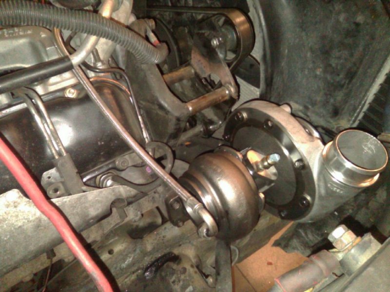

Ok, I will give a little more in depth background, just for you Will L lol So with the new injection pump I have, I have an immense amount of fueling down low to about 3200rpm. The HX40 made decent work of this but sacrificed a little on the bottom end because I went with a setup that would allow me to still keep it highway friendly with 4.10 gears on long trips. Well, I got a 2nd vehicle for myself (1987 Danger Ranger, KING CAB lol, super nice little runnin around truck though, 4.10's with a V6) which means my 6.5L is kinda now moved to strictly play toy instead of daily, which opens up a huge amount of possibility. I wanted to always try a Borg Warner series of turbo out of curiosity. I didn't want to sacrifice airflow and step down from my HX40's airflow potential, so I went with the biggest exducer compressor wheel I could find while still keeping a 68/76 turbine wheel, because it was most similiar to my HX40's turbine wheel and I liked the characteristics of it. And the result from that search was the S364.5/68 SX-E. I chose the SX-E over the SX series because of the flow characteristics, and stronger internals, and the fact it was only available in the SX-E series, so it worked out good. I had to think about the turbine side for a while, but I felt comfortable going with the 0.63 A/R on the turbine side. To some it may seem to small, but to create the characteristics I wanted, it works. I know the shaft size is upgraded from the HX40, both wheels are immensly bigger, and the turbine is an open scroll housing, so I wanted to still get predictable spool so I chose the 0.63, and I got to say, no regrets at all. It looks super funny, yes. But the performance gain to best match my fuel curve is almost laughably huge. There was a lot of choices I had for turbines (12cm, 12cm wastegated, 14cm, 14cm wastegated, a shit ton of huge T3 and T4 mounts) but I feel I tuned the turbo to my needs perfectly. And isn't that the goal
