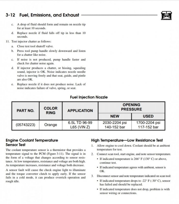

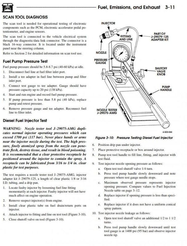

It might be a good idea to get Your injectors tested, or buy or make Your own injector test stand. If You are not aboe to access that equipment, then You might want to get on Leroy Diesel web site and check out a set of his injectors.
Another thought, if there is a John Deere equipment shop in Your area, they too might be able to test Your injectors. Even if they cant adjust them, they should be able to let You know if You have faulty ones.
I will never again install a set of injectors before testing them.

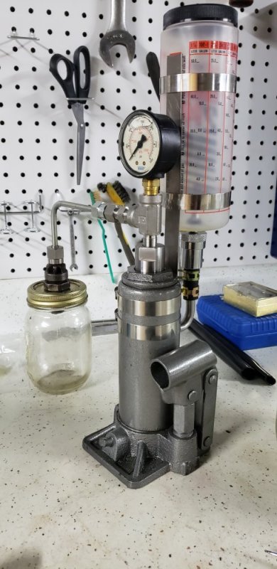

A good pop tester isn't cheap. And I wouldn't trust the Amazon special to do the job. You can build your own from a bottle jack and get a good quality tool for cheap.
Here's mine I just finished putting together the other day.
