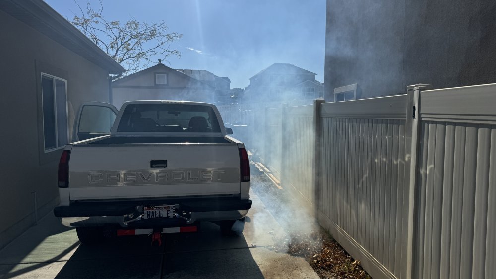

Notice while up in MT last summer trying to be of help to Big-T that my first starts were starting to have a little smoke. Hmmm Acrid diesel smoke that cleared up quickly as engine came to life.
It was kinda hit and miss up there but, when it ‘hit’, the smokewas getting a little worse. Longer in duration.
With the colder weather setting in, the smoke has gotten thicker and, as the engine takes a little longer to get happy, the duration increases. Smoke lasts for no more than 40 seconds or so…so far.
While smoking there is a noticeable miss or stutter and, sometimes, a loud ‘fop fop fop’ for a few seconds. Cold Hole?
I’ve confirmed the Glow Plug Controller is operating correctly.
1st, key off, I confirmed there was 12v present across the GP controllers posts (12v in and GP Wires Out). So, connectivity to the glow plugs.
2nd, heard the load “CLICK” from the GP Controller when turning the key to RUN and starting the GP Cycle. During the GP cycle, no 12 volts across the GP controller’s two posts..
3rd, 12v present confirmed at a couple of the GP wire terminals so some of wires are sorta good.
Pulled a couple of the GPs and put 12v to them and they heated up fine. Will test them all though.
On the ones I checked, I did notice the GP wire’s connectors slide on to the GP blades almost too easily and don’t fit snug. Last summer, while wrestling with Starter connection 101, BigT noticed my #4 GP wire wasn’t connected to the plug and the connector was melted. Odd for ceramic ends to do that.
When the glow plug connectors fit loose, the wires draw far more ohms which heats the GP Wire connectors a lot, but passes less power to the plugs so the actual heat cycle could be far less than ideal. This harness is almost 13 years old (can’t believe it’s been that long) and with the long term issues I had with the valves (different thread), I’ve connected, disconnected and reconnected the GPs far too many times. Had I not had to fiddle fart with things so much, I’m sure the connectors would be good and tight still.
I have eight new AC Delco 60g GP plugs but, the Duraterms I’ve checked on the driver’s side are heating up OK. Prefer Duraterms though. Yeah, I remember a few years ago they were supposedly turning to crap along with the India Injectors. Haven’t heard anything bad about them lately.
Plan of action now is to pull all the plugs and test them. Pull and replace the GP Wiring harnesses (even if I can squeeze the connectors to give a better fit) on both passenger and driver’s sides. I don’t trust the connector on #4.
New Duraterms arrived a few days ago and the new GP Harness from Zombie Solutions arrived this afternoon.
Will probably hit the job Friday or Saturday. Going to pull the inner fender to assist in getting at 4,6 and 8 and assist in routing in the new harness and me shoulders and wrist are still fighting back after the fall down the stairs a couple of weeks ago. Glad this isn’t my only available vehicle anymore. Still, had to replace a tire because I picked up a construction staple (red) and two dry wall knife blades (yellow).

Your's is doing what mine is doing, started fine until the temps got lower than 20. It still starts pretty good but I have one injector hanging up until it gets a little heat into it.
Thought about Injectors too so, I have a new set that I want to get tested before swapping in.
The current set of Duraturm’s have been in since 2013 though and are easier to get at so I’ll do ‘em first.
That “Fop” sound at cold start up is consistent over the last few years and I’ve had a three different sets trying to diagnose what turned out to be bad valves.
Last winter, the first one since getting it back with the new heads, it didn’t smoke but, that ‘Fop’ noise was there occasionally on the colder mornings (which would still be considered balmy when compared to Alaska) when the truck wasn’t plugged in. This year, it hasn’t presented that noise but once. So weird.

Yep, when mine smoked like that, it was the injectors.
We all can spend money and pay others to fix the trucks. Instead we buy tools and diy. Long term owning a 6.2/6.5 it makes sense to me to have a pop tester.
Diy make one for cheap. Sometimes gubmint auctions have them cheap. Ebay sells a cheap one you can flush really well, adapt your injection line to, and put on a better gauge.
Now with some patience you can adjust the pop level yourself, have a spare set of injectors to swap as you go for less downtime. End up with two sets adjusted to individual desires of power/ mpg. And be able to diagnose when there is a problem.
