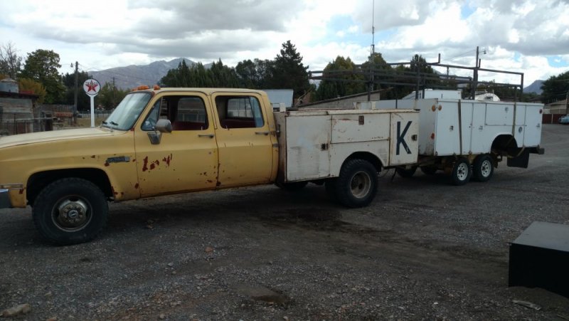

After realizing that the 9ft service bed on my truck was too small for all my tools, and was killing my fuel economy, decided that moving the tools to a trailer would be the best option. Lucked out and found this 11ft Reading bed for $250 that was a few miles down the road and in much better shape. The planned trailer to pick it up was occupied so used this small but stout trailer to recover it.

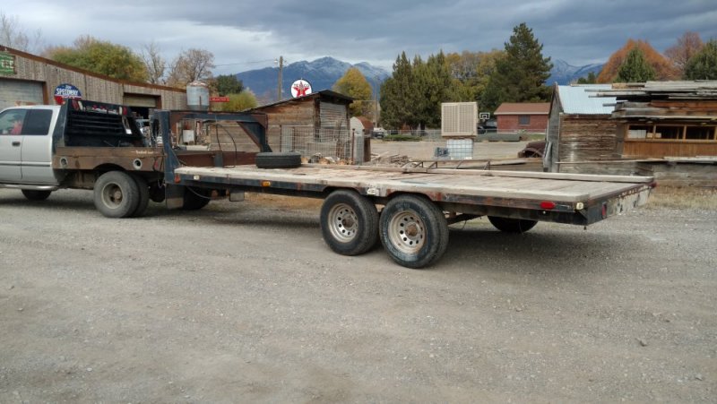

Trailer wasn't a high priority since my truck currently can't pull a gooseneck until the bed gets swapped and for some reason people here think that a used gooseneck is worth about as much as new. Well a buddy mentioned today that one of his neighbors is selling a little lightweight gooseneck flatbed for cheaper than I could turn a truck chassis into a trailer. After a little bit of negotiating I now have a 20ft gooseneck trailer. Needs a hub rebuilt/replaced and tires.

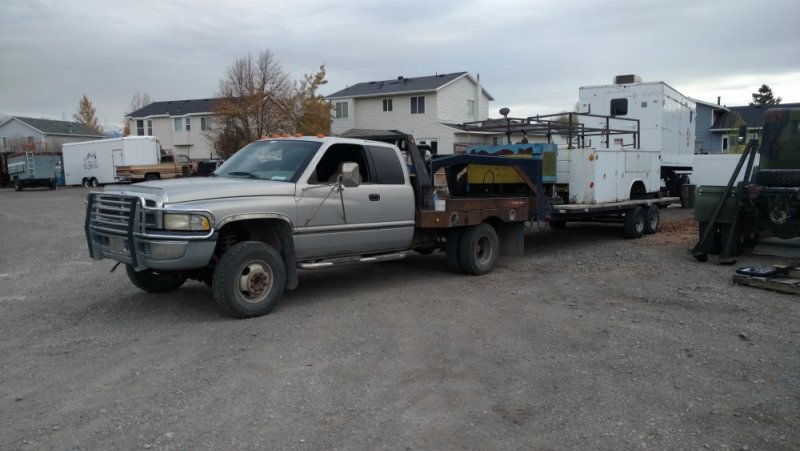

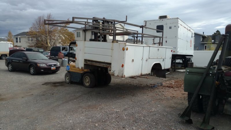

Little bit of heavy lifting with the forklift

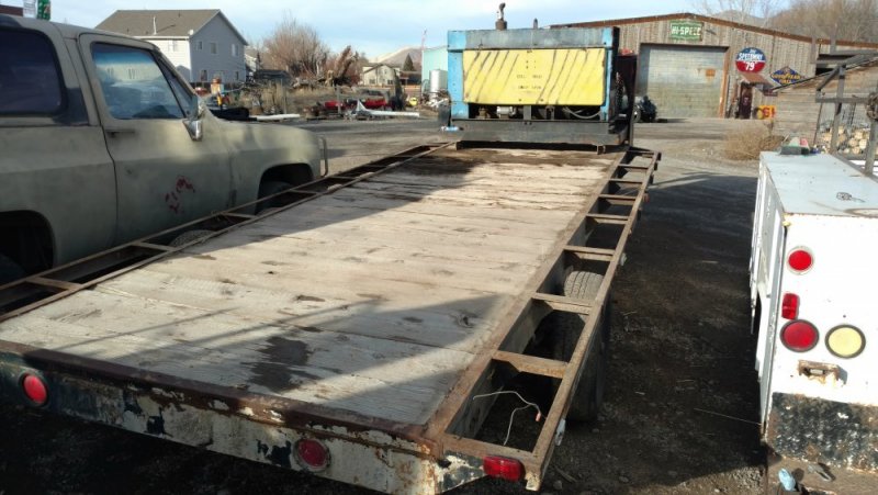

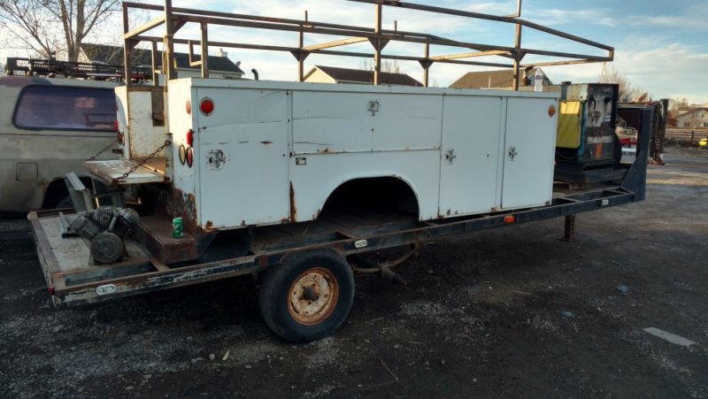

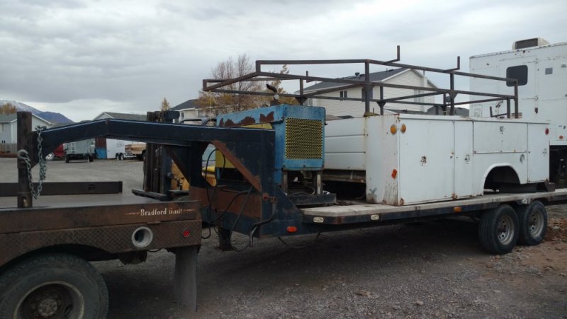

And voila, now have the main parts assembled for the service trailer.
The trailer deck is 8ft wide while the service bed is 7ft 7in wide so with the bed centered there are 2 1/2in of extra trailer width. I kind of like that because if I happen to be towing it somewhere and end up scraping the trailer edges, it doesn't shred the box.
There's been a few ideas so far on what to put in the wheel well openings hahaha.
There's not much of a set design layout yet for the trailer but I do want it to look nice, not thrown together. #1 requirement is easy access from the ground so no top boxes. The wooden deck on the outside edges sits higher than the rest of the bed so going to pull those boards which lowers the box 2". Gets everything as low as it can be with easy access. The ladder/pipe rack is coming off.

If I need that much extra room the easiest way would be to just set the 2 complete boxes end to end. Imagine the first picture but with both boxes on the trailer. Welder mounted with it's face accessible from behind the gooseneck. Don't think I'll have a need for THAT much room though hahaha.

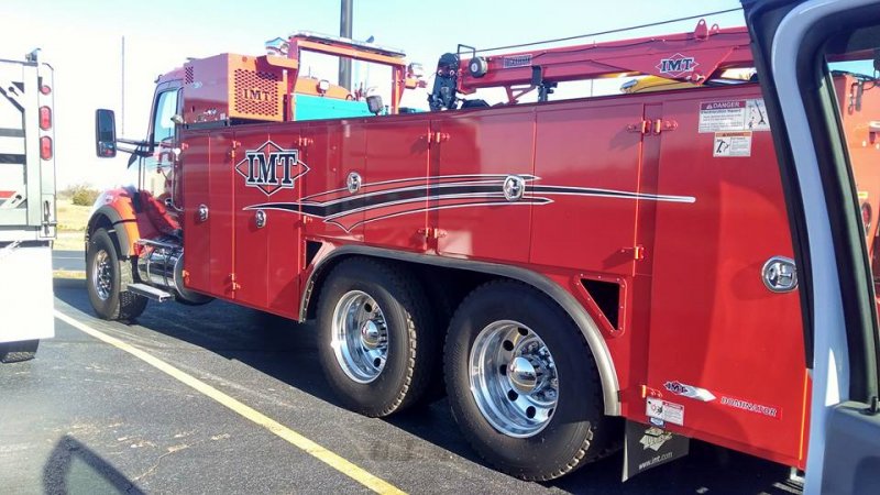

Or bigger, like these? haha
Building off of your idea Marty:
Use the front 3 sets of boxes from the 11ft Reading bed (including wheel well boxes), then the rear 2 boxes from the Knapheid bed (wheel well and rear boxes). Followed by the rear boxes from the Reading bed. Or maybe just the wheel well boxes from the Knapheid bed.

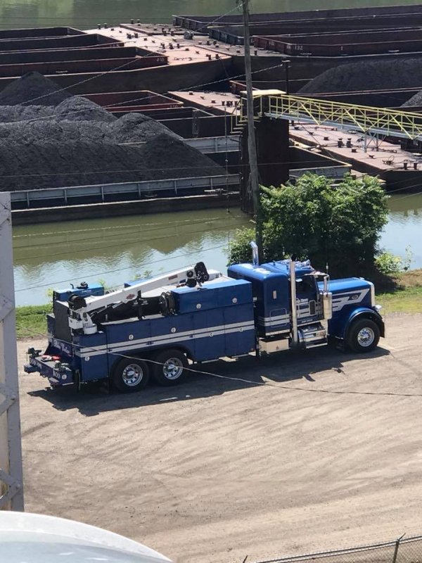

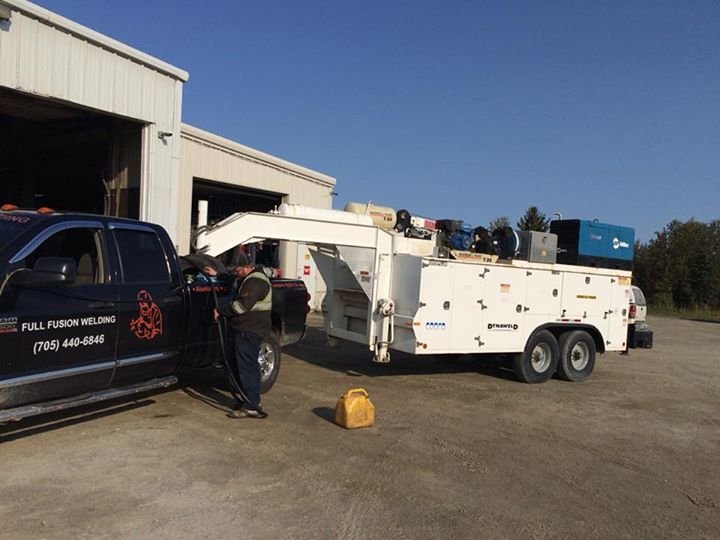

Use is for a mix of personal and business so it does need to look professional. When it comes to design it will end up similar to that gooseneck service trailer I posted up a pic of, minus all the stuff on top of the boxes that they have.

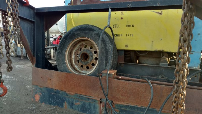

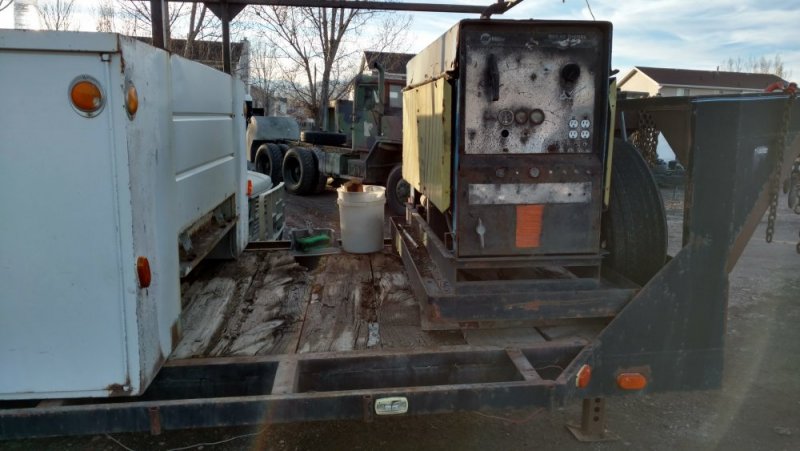

Bit of work today on the trailer. Pulled the service bed off and removed those outer boards from the deck which lowered the bed about 2".
Needs a new hub assembly on that side just not bothering with it yet.
Moved the welder back enough to make room for the spare tire. It'l get secured properly just wanted to get everything into it's location for now.
Lastly set the bed in it's planned location and ran a few bolts through the bottom of the front boxes. The rear of the bed needs to come down which will happen when the rear bumper gets cut off. Then to decide if the last few feet of deck will get cut off the trailer, or if that will become the work bench. The deck is too low currently for a comfortable work height unless there was something tall sitting there (larger engine for example).

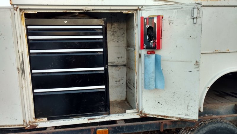

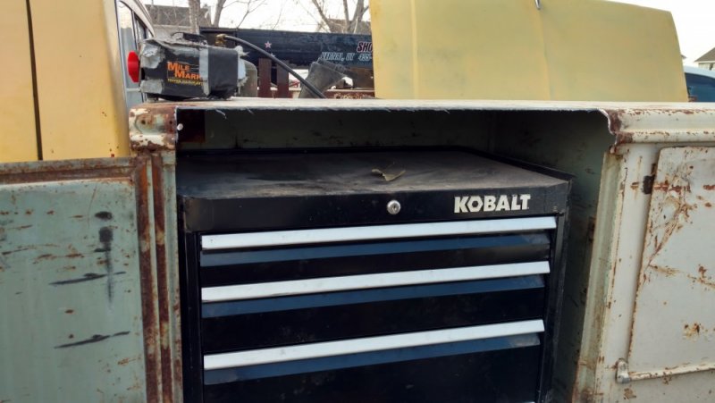

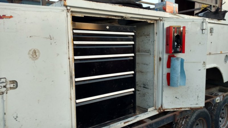

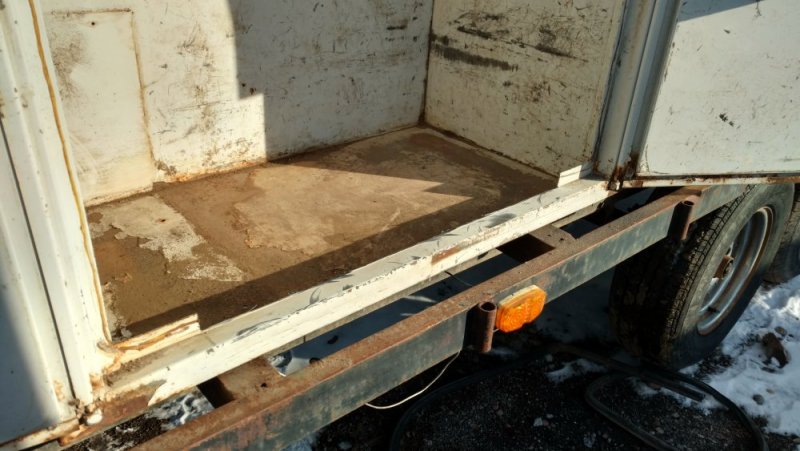

Now that the holidays are over and it got above freezing today figured I'd do some project work. For those that might remember from the crew cab build it took some cutting/welding to get the tool box into the old service bed. No surprise, same thing to get it out of there haha.
New bed has the same problem. Trimmed the sealing edge on the top/bottom, and trimmed the excess material off of the top of the box as well which gave just enough room to squeeze it into the new service bed.
Leaves some room alongside the box for other stuff, about 9" wide spot. Undecided what will go there. But there's a problem, not enough space between the door latches and the tool box. The shorter door is an easier fix that just needs some flat strap added to it, making the latch easier to reach. The main door however has no room for it's lower mechanism. The upper clears the box, but I'll need to either cut into the bottom of the box, or remove the lower mechanism from the door.
Hmm, tough problem. I always come up with harder solutions first, then later the easier one hits me, sometimes. If that happens I’ll speak up. But...
What if you remove handle and rods, cut a hole and mount it into the right side of the right door where the open space is. Cut the hinge pins on the right door. Weld the right door to the left door so now it is one big door that hinges on the left (which is what you want-always hings doors so if left open and drive away wind closes not opens them). When you cut the handle opening in the right door, do so cleanly to reuse the piece to fill in hole where the handle came out of.

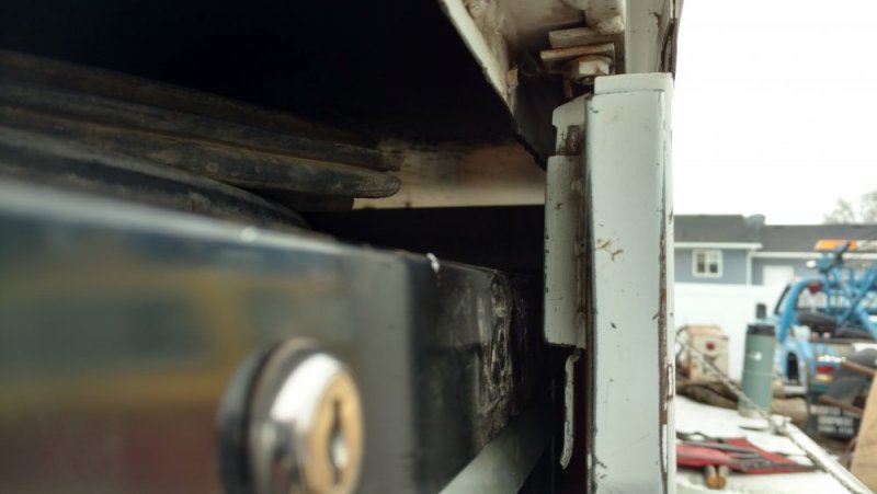

Otherwise, can you show how much of the latch system is in the way? Is it just the door to door latch or do the rods attachment hit also?

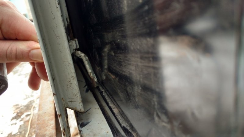

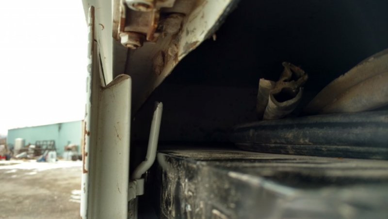

Couple pics of the door latch issues. The doors don't latch to each other, they each secure to the box.
Short door with only a upper latch (this one should be an easy fix by just extending the tab closer to the door opening)
Then the larger left door, pics of upper/lower latches. The upper is workable as is, the lower is not.
A mod that a friend mentioned would be to make the left door latch pins completely straight and just drill new holes for them to secure into the service bed body.

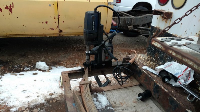

Used the trailer today for working on the replacement springs for the crew cab (new urethane bushings). The deck of the rear work bench is too low by about a foot which was already known. An idea for a new addition though came up today. Needed the mag drill to sit higher so I clamped a piece of angle iron to the rail and raised it up a few inches off the deck. Thinking of making some kind of adjustable height platform that the mag drill or anything else could use.
