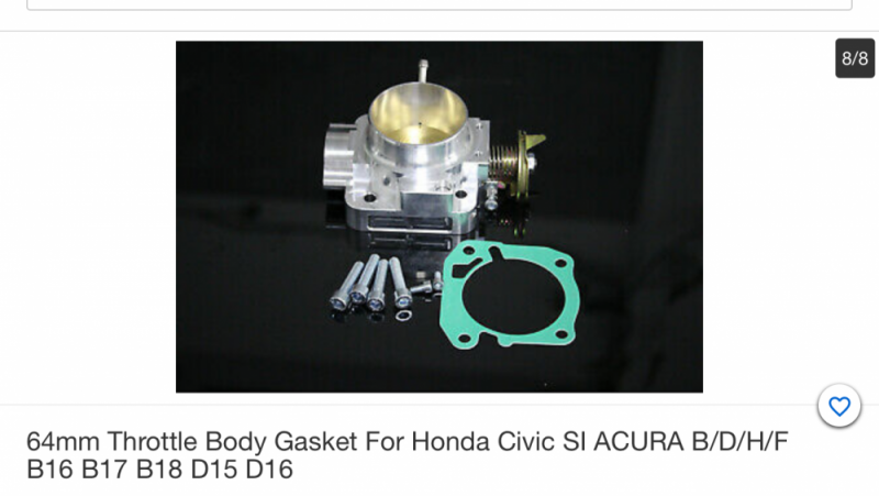

Exactly the game plan minus the junkyard. I planned on buying returnable chineseium throttle bodies until settling on a descent one. 2 1/2” is 64mm, 3” is 77mm, throttle bodies are listed in mm. Rounding up/ go to next common larger size.
Make sure the butterfly opens to perfectly flat and make a detent for it to rest in that position so the cable does not hold the load.
Make sure the “idle” position closes 100%
Kill any external “vacuum” ports unless you want it as a boost gauge or air temp port.
For inline, you’ll need to weld 2 new flanges on, or use your new flange at the downstream side making a large contact area and bead to ensure the downside hose can not blow off under high pressure. Actually having a weak link at someplace upstream although could be annoying is smarter so a 6,000 rpm runaway building say 35 psi boost will never blow off that all important downstream connection. Buying a multi tooth king nipple to use may be better than a pipe with a single groove. They are hard to install but usually require cutting off the hose to remove.
Another option is using the flat top plate design and Bolting on the throttle body directly to it. I’ll find a couple possible examples from fleabay and edit post shortly.
So this could be one used for inline. Weld on a chopped king nipple to the back or make a bolt on plate with king nipple for the back.
The front is very short and could cause easily blown off hose under boost, so welding addition onto it maybe needed.
Note the vacuum port as mentioned. I really doubt accurate boost would be read as it is in a peak flow area and temp readings would be altered too from airflow, so plugging the this one would be required.
Removing the spring to auto close definitely required.

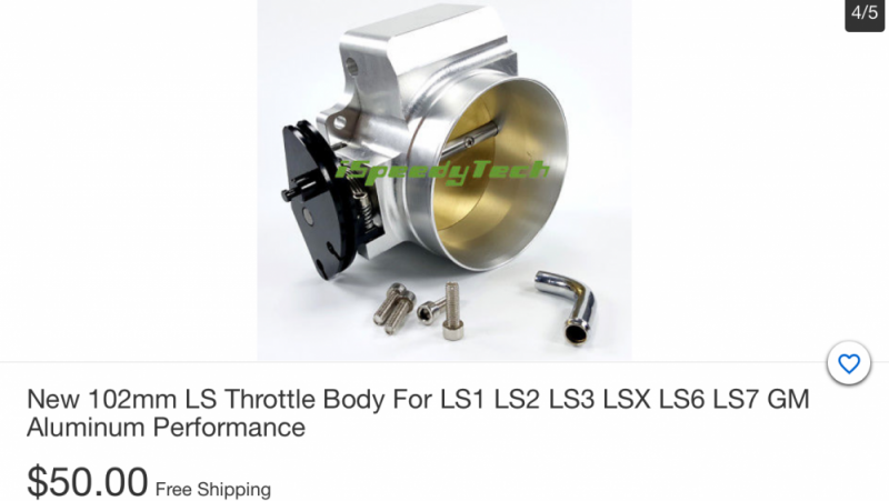

Want high performance and mega flow with a 4” hose coming off your turbo? 102mm throttle bodies are out there too.
This one is at an amazing price about half that of most 102 for sell. So I would expect to return this one after inspection, but who knows?
Again notice the tiny area to attach the hose. On a plain gas engine, there is vacuum not pressure, and I will
Also tell you from Ownership of LS engines, the intake piece just popped off too easy on these. Watch professional mechanics work on them and they just push down on them to remove bever having loosened the clamp even because it saves time. Adding to this one is a flat requirement.

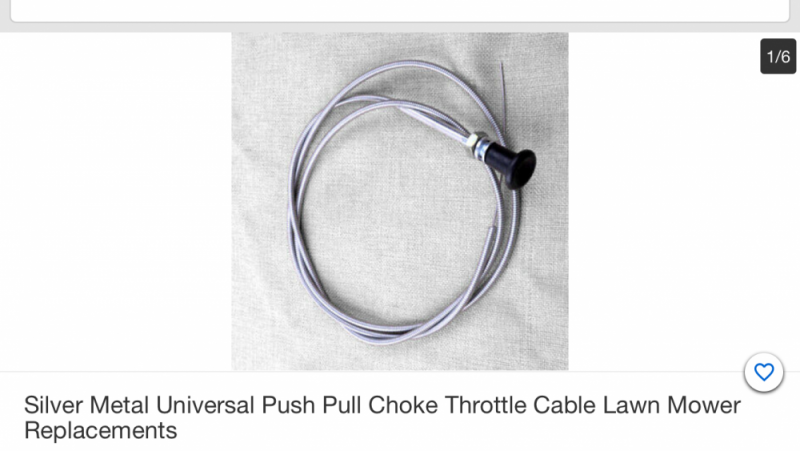

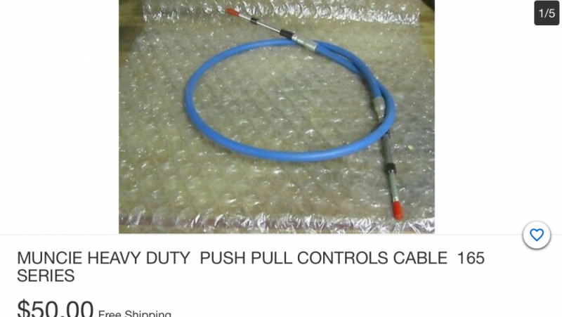

AVOID cheap cables. They create problems, rust solid, allows dirt to build up inside, etc. example:
A quality cable will last a lifetime and be reliable. This is a pto control cable, I have installed a couple hundred of these and they took abuse and outlast the pto. Doesn’t need to be this brand, but at least match the quality and being a sealed cable is always best.
Note this does not come with the mounting hardware, handle, end attachment unit.
A factory throttle cable with mount could be a good option also, you just need to do some fabrication to make the pull handle.
Make sure the cable is pushed in for normal operation and has to be pulled out to kill the engine.
