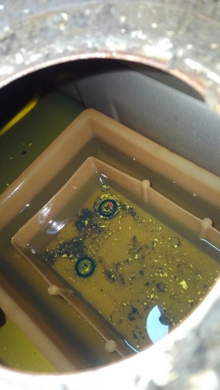

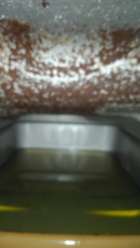

Every time I change my fuel filter there is a little silver metallic stuff in the bottom of the FFM. Could never figure out what it was. So when I finally decide to put an inline fuel filter before my lift pump and eliminate the sock filter in the fuel tank I made a discovery. In the fuel tank was all kinds of neat little silver flakes which come to find out is the liner of the tank. I don't know if it's just from age or from when the gas station accidentally put gasoline in the tank if that could have damaged it I don't know. Doesn't really matter. The top half of the tank is rusting all to hell and peeling and I do not have the money to buy a fuel tank right now.

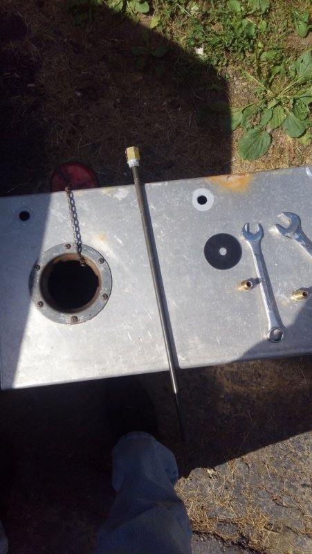

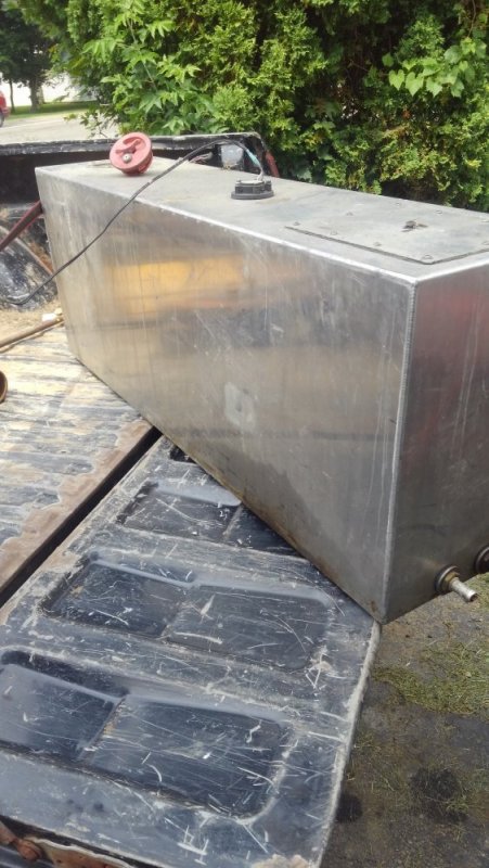

It's so happens that I have a 35 gallon auxiliary fuel tank / transfer tank that is aluminum. Not really set up for this application so I adapted it again with Will's help on how to do it. There won't be any filter in the tank just a line going in and a line going out and on the side of it there are fittings for a tank heater to hook it to the cooling system which will be beneficial here in New York.

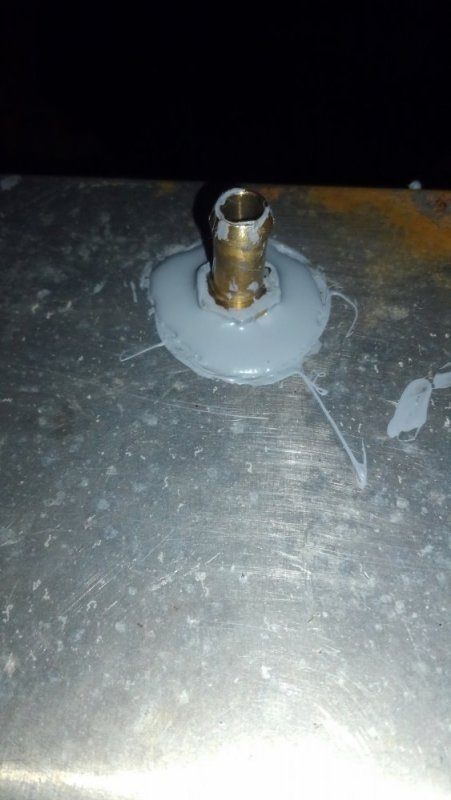

Really all I had to do was drill two holes in the top of the tank, and made a trip to AutoZone got two pieces of brake line and a couple of nipples and couplers out of the help section and a bunch of 3/8" fuel hose. Just got it finished finally waiting for the permatex to dry overnight before I hook the hoses up..
