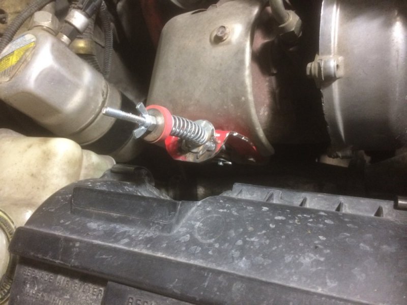

The wastegate solenoid is the most common failing part in the whole system. Chances are if you have problems, this is it. Now, don’t just condemn it because it’s everyone else’s problem. Verify first that it is bad. How?
How do I determine if my Wastegate Solenoid is bad? You must see if there is vacuum before and after it. Locate the solenoid by tracing the vacuum line back from the wastegate actuator. You will need to determine if you have vacuum after the solenoid. You’re looking for about 15” of vacuum. Many refer to this a pressure. It’s not really pressure, but suction. Notice I did not say 15 psig, but 15”.
This little valve has three ports. Only two of which you hook vacuum lines to. One is the vacuum source (to the vacuum pump), the wastegate actuator, and vent. Vent, is not something you hook anything to. Why a vent? That is how it regulates the amount of vacuum going to the actuator. There is a little steel ball inside the valve that switches back and forth between vacuum and vent. Here lies the problem. That ball will rust. When it rusts, it won’t roll anymore, so your engine power no longer rocks. Thus, you ain’t rock’n’rollin’ anymore. When the ball doesn’t move, it will get stuck and not allow vacuum (usually) to the wastegate actuator, leaving it open all the time. This means a no-boost situation.
The solenoid can fail in a vareity of different ways. It can fail to provide no vacuum to the actuator. (most common) It fail to provide vacuum always (not as common, but possible), the coil could fail, or no power to the coil from the ECM. Sometimes the ball will “stick” causing erratic boost, where it will spike up and down.
Can you fix this? Yes, replace it. No repairs ever found really. You can “limp it along” by spraying something like WD40 into the port. This may help to free it up, but it won’t live forever.
Where can I get one? Usually it’s a dealer item. Local parts stores don’t seem to have this item for some reason. Check around, there are some on-line parts sources.
I have no vacuum before the solenoid? You should check to see if your vacuum pump is working. If you have no vacuum present before the solenoid, then you either have a bad vacuum pump, or a leak somewhere. Chances are if you have an EGR equipped engine, you’ll have EGR codes if you have no vacuum, because they are all vacuum driven.
Weak vacuum too will also cause problems. You should have around 26"hg of vacuum available at the pump.
Where is my vacuum pump? It is driven by the serpentine belt.
Don’t rule out vacuum leaks. If you have a leak, you maybe changing parts that work just fine.
