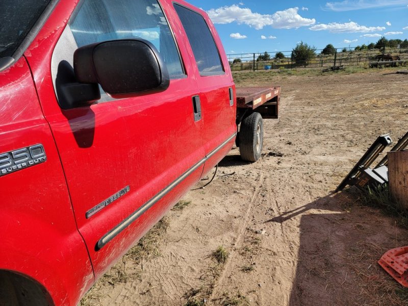

Wonder if this truck will break the average 2 year truck lifespan with me haha.
1999 F350 4x4 with 7.3 powerstroke and 4 speed auto. Trans was rebuilt about 15k miles ago, has 300k miles on the chassis but honestly less blowby than the 6.5 in the HD had when it was healthy. Behaves stock with engine performance. Had a small fuel leak from the filter assembly which from what I've found is a very common issue on these engines. Great body besides the bed and front bumper.
First big trip was to recover the HD, bring it up from southern Utah to northern Utah. Since it has the stock tiny transmission cooler I kept it in 3rd gear at 60mph.
Little over halfway had a tire fail, caught it before it popped.
That was on the 1st day of ownership. Day 3 it got hit while exiting the highway. I was partway into the exit lane when the car that had been behind me decided to exit and pass me at the same time. Resulted in scratching the paint on the front passenger door around the plastic strip. His driver door was damaged and the front fender got chewed up by my tire (no tire damage for me). He emphatically wanted the cops involved, and gave a dramatic presentation to the highway patrol officer about "This truck tried to run me over and now I can barely stand because my left leg hurts, and I just got my car back from the body shop yesterday!" Literally, one of those guys. Sounded like the officer gave him a reckless driving ticket so a bit of karma there. Tried to claim that damage on the rear corner of his car wash from the truck but the officer pointed out that the mud on my truck wasn't even disturbed (same height), indicating that no contact was made there.

I'm not worried about the engine needing a rebuild for at least a few years, the little bit of blowby isn't significant enough to be a problem yet.

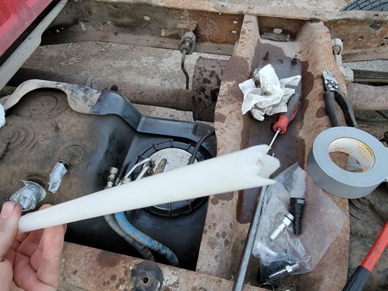

The fuel leak however, is getting fixed this week as it has gotten worse. Went ahead and upgraded to a fuel filter bypass and hard line upgrade from CNC Fab rather than fight with the stock filter housing and known problematic stock fuel lines. Using the Raptor 150 lift pump and 2 filter setup from the HD on the F350. Replaced the fuel pickup tube in the tank with a 1/2in model as well. Installing that stuff as the bed gets swapped. Cut the front 2ft off the bed and did the first test fit on the truck.

It's going to get a heavy front bumper and rock sliders along the cab for offroad protection, didn't figure I'd need any armor by day 3. The guy also tried to claim that the bed damage at the rear on the Ford was from the accident. Showed the officer the flat tire pics from the HD recovery 2 days prior which clearly pointed out the bed damage was from a previous wreck.
Did some test plumbing for the fuel. Stock tank under the bed, both filters and lift pump on top of the bed like before, it seems to draw the fuel just fine.
Next step is the bed mounts. Then run the new 1/2in fuel supply line, rip out the old supply, and take everything off the intake valley to install the new filter bypass and hard lines.

I'm not too knowledgeable on the ford diesels, but when using an external lift pump, I would open up the tank and eliminate that sock strainer in there plus install an inline filter between the lift and the tank, this way you'll hopefully never need to open the tank again!

Pickup tube looks good :) Might consider checking-out the Harpoon mod as this will make the fills easier.

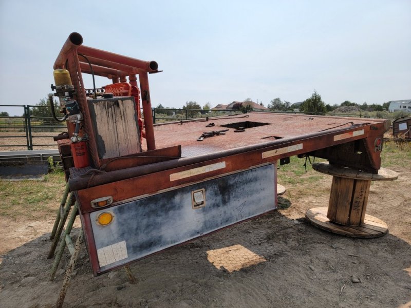

Not decided yet on how the stock tank will get filled with the new bed. There are 4 options I'm looking over :
1. Filler located at the outside edge of the bed (common flatbed spot). Known to be a problem with regular flatbeds due to the shallow angle and because of the gin poles the filler would be sitting ever lower than usual. Not really in the plan.
2. Cut a access door in the bed and fill there. Viable option since the first 2 feet of the bed is occupied by the headache rack so shouldn't often have an issue with access. Could accidentally place cargo over the door preventing fill-up.
3. Filler neck secured to the headache rack. Basically vertical fill angle, no risk of access getting blocked. But the filler hose could possibly be cut on accident.
4. Only fill the bed tank. Cap off the stock tank Filler neck and use a pump to transfer fuel from the bed tank down to the stock tank.
Options 2 and 3 are mostly a difference in how long the filler hose will be.

No matter which option for the filler neck, the Harpoon Mod should help as it will reduce foaming while adding fuel. If not already familiar with this tank, the last 3 gallons take as long to dribble-in as the first 35 took to go full blast.
I have seen custom installs with the filler neck attached to the headache rack. Common mount is to put the opening between the cab and rack. Going this route will also add a bit more capacity to the tank.

Just read up on the Harpoon mod. If I'd known about it when installing the new 1/2in pickup tube I would have done it, but not going to fight with that damn locking ring on the tank again haha. Reason being is the black plastic locking ring on mine is warped, took a good 45 minutes just to thread it on and that was with the bed off/easy access.
Since there is a 60 gallon tank on the bed, I'll just fill the stock tank till it clicks then fill the bed tank. Finally go back to the stock tank for 1 more click if I want to fight for the last 3 gallons.
