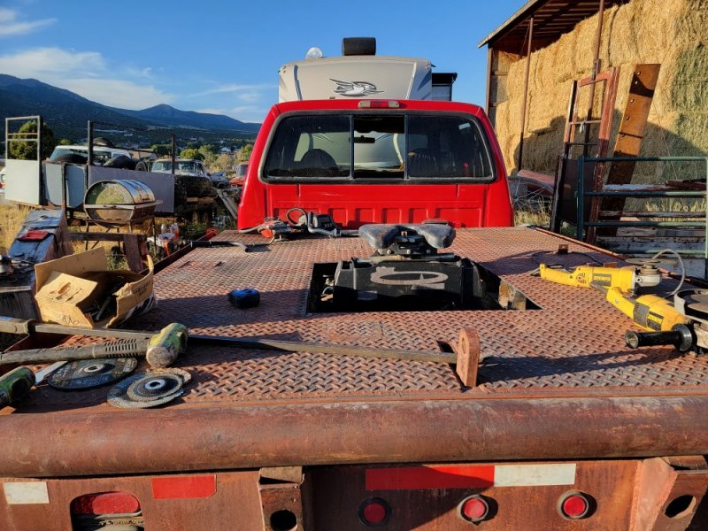

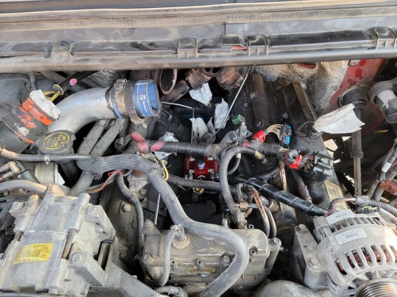

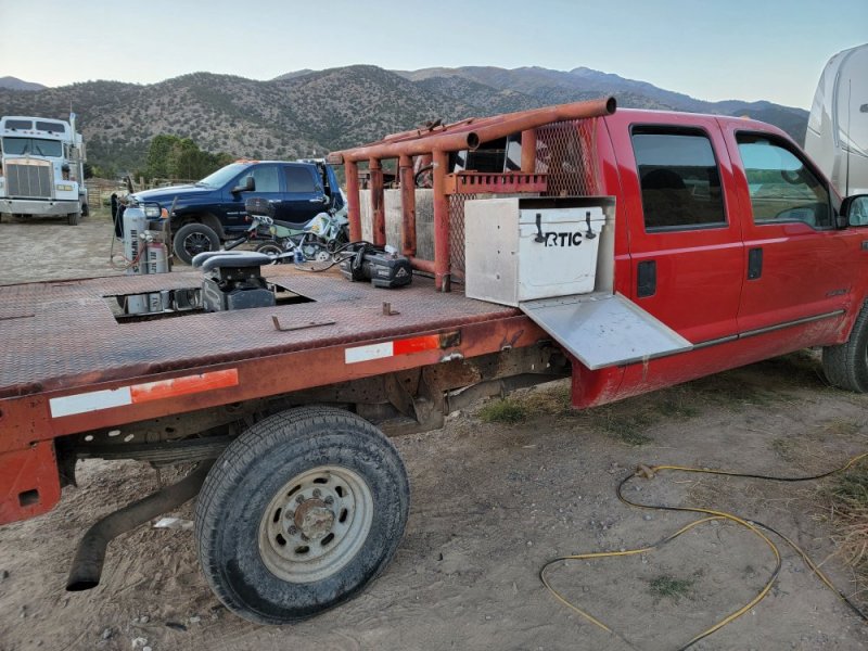

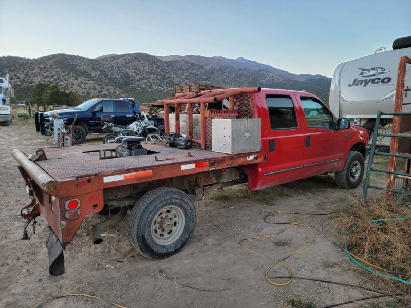

Based on the last photo, it looks like there is some soot coming out of passenger side uppipe.
If so, now is a good time to ditch those doughnut style pipes for the IH style bellows uppipe. Can go cheap with Dorman OE doughnut style, or check out RiffRaff for IH bellows.

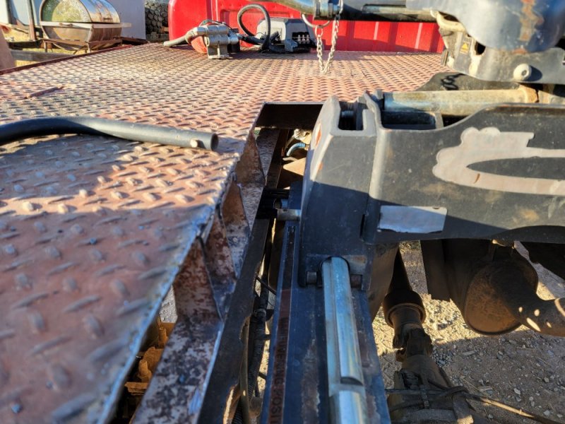

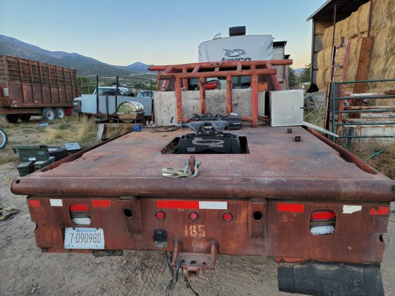

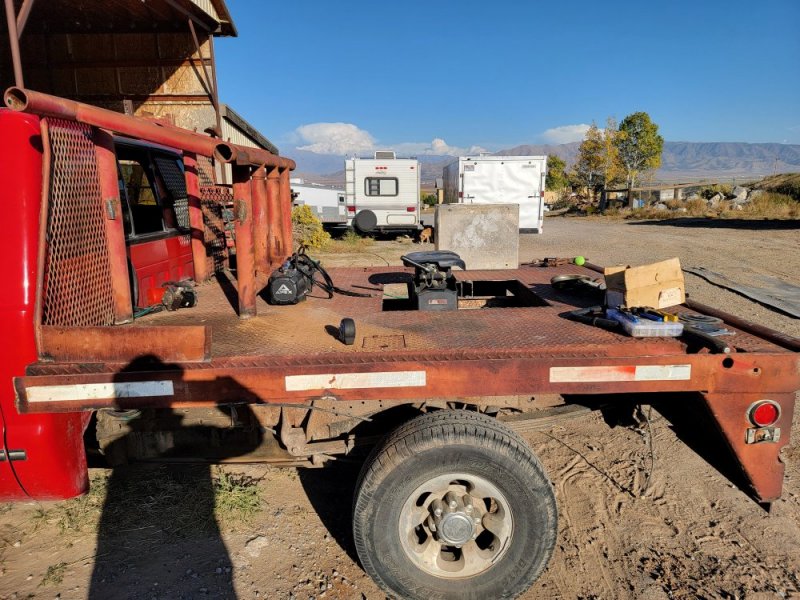

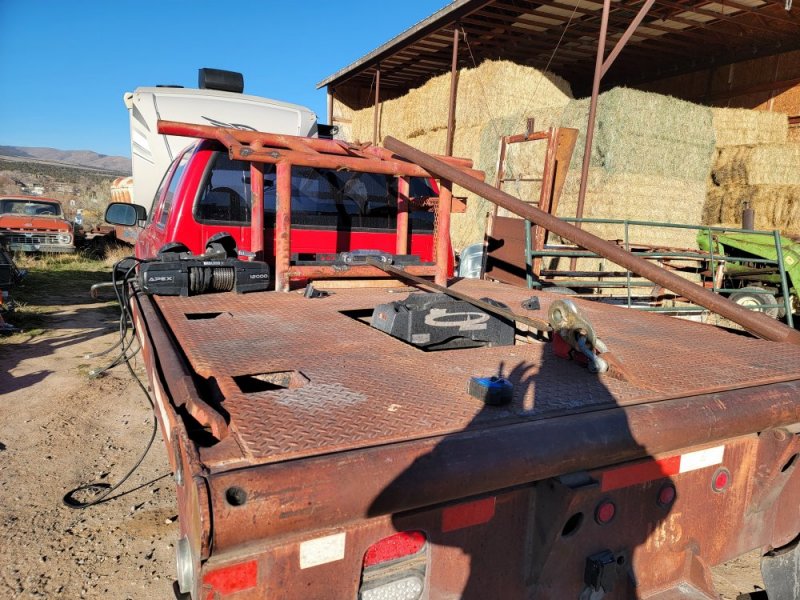

Gonna paint it all when you're done, or go for that antiqued look?
