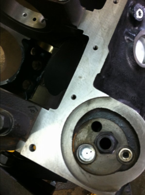

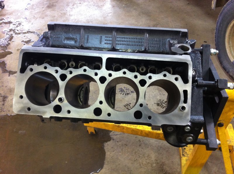

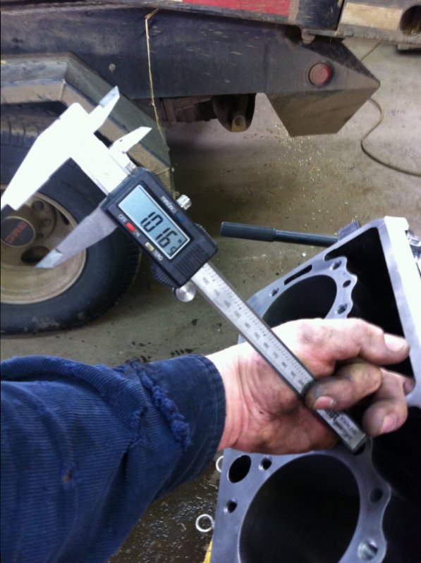

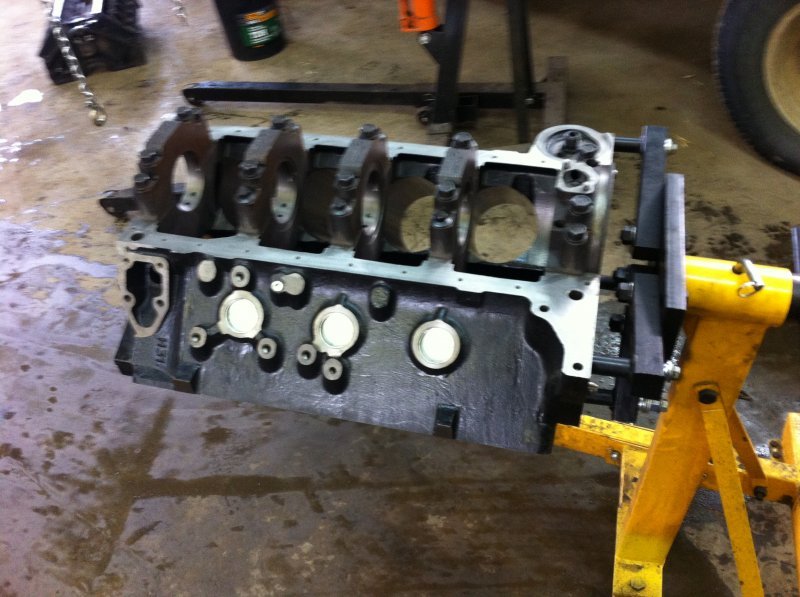

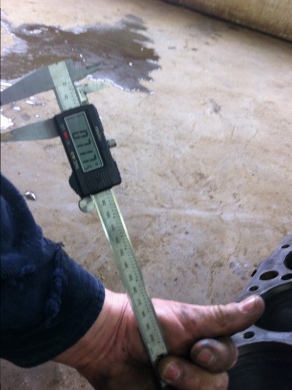

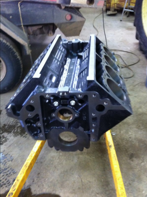

The old block has a 1/4" less deck thickness or more than the Chinese. That is part of the 30lbs difference Simon mentioned. This will benefit the TTY bolts more than studs.
