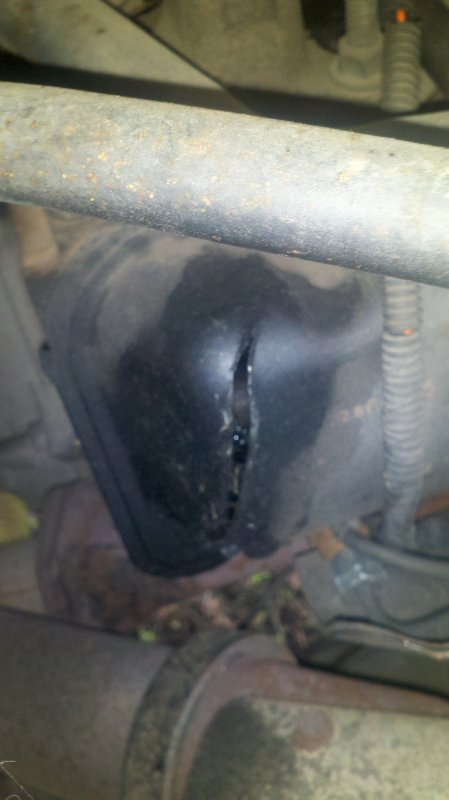

This doesn't answer your questions, but here was my rocker issue.
