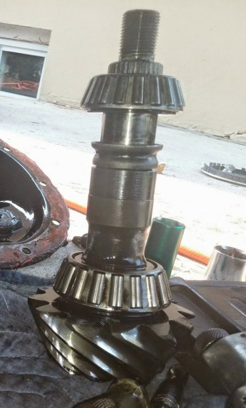

Do you have tools like a torque wrench and dial indicators for checking gear play? If not then you will need them to rebuild it. You have to pull the diff cover, remove the differential cross bolt, remove the axle c clips, slide the axles out, reinstall the cross bolt, remove the carrier, then remove the pinion. Then you can go in and press off the old bearings, drive out the old races, install the new races, and bearings. Install the pinion without a crush sleeve to start with and loosely snugging the pinion nut up just eneough to take the bearing play out, install the carrier, set your backlash, and then run a print on your gears to verify pinion depth. If the print is good, then you remove the carrier, remove the pinion, then install the crush sleeve, install the pinion, and tighten it down to crush the crush sleeve until you obtain your 20-30 inch pounds of rotational force required to turn the pinion. Install the carrier and set your backlash to .008 or so, and set your preload on the carrier, and then finish it up by putting the axles and such back in it. If your not familiar with rebuilding diffs, then you should know it is not an easy job, and it is more or less an artform to rebuilding them and keeping them from howling.
