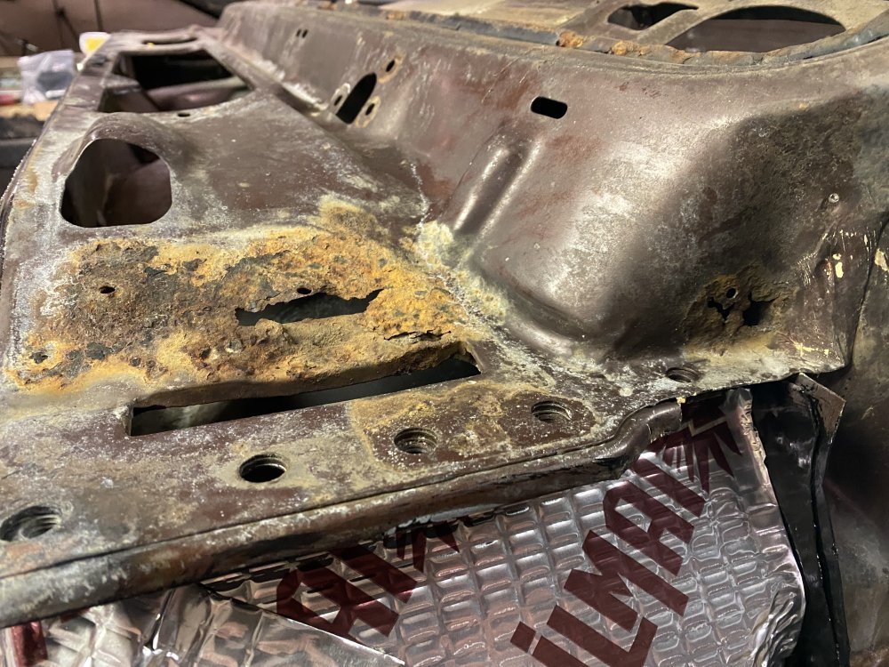

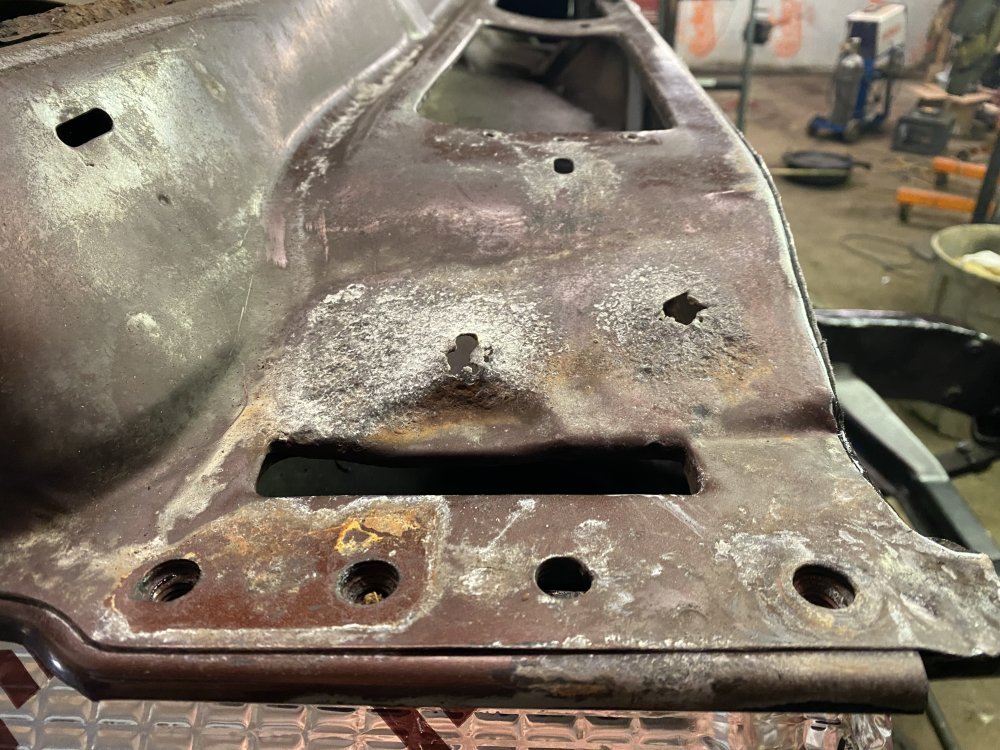

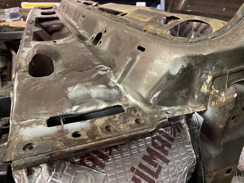

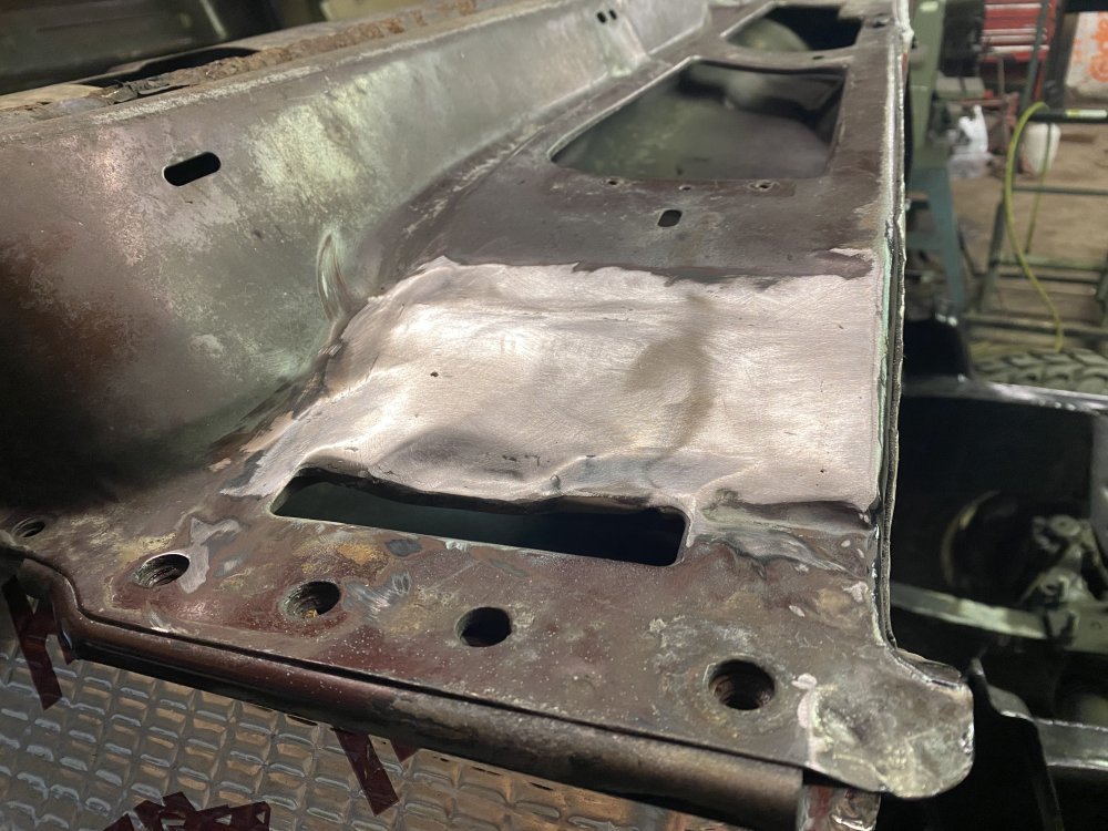

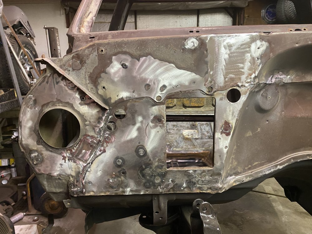

This weekend I got the firewall repair done.

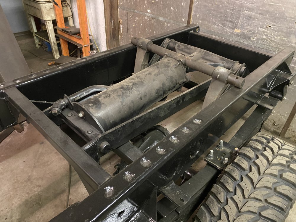

I also got the dump hoist reinstalled.

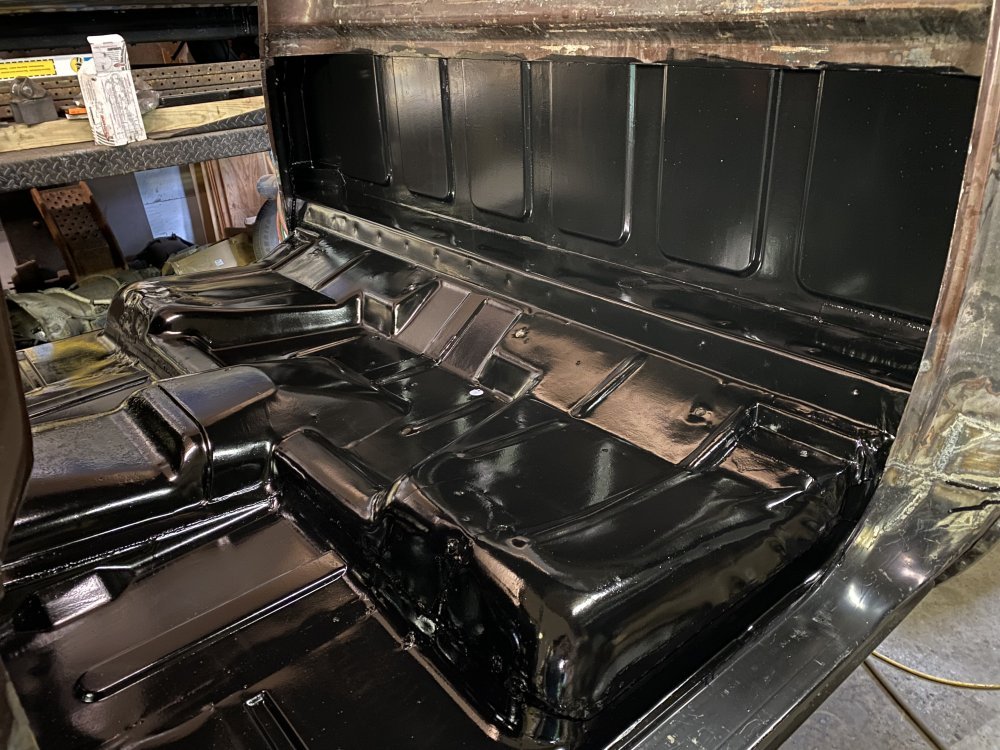

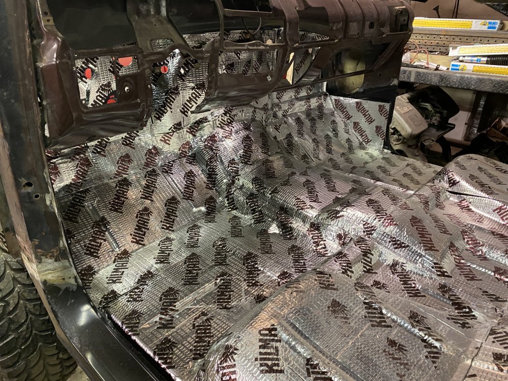

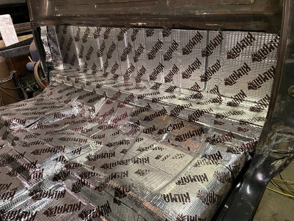

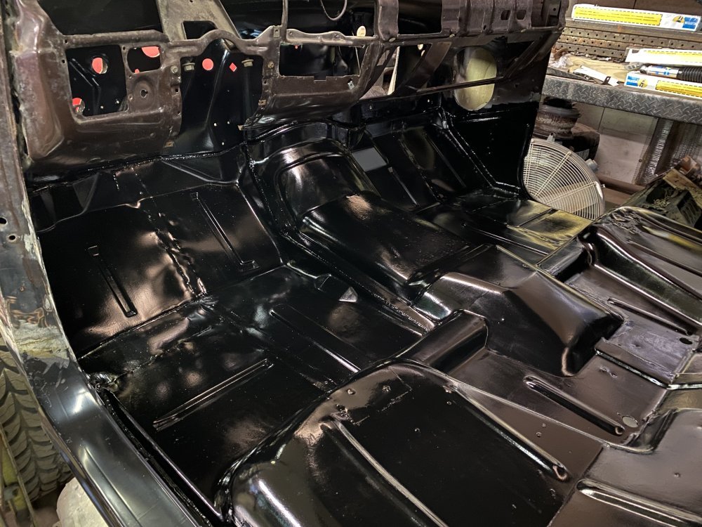

I got the floor painted with 2 coats of Rust Seal.

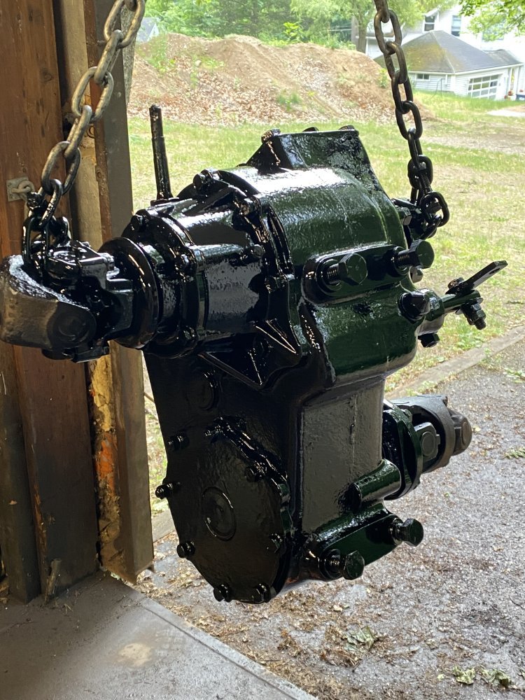

And I got a few coats of Rustoleum sprayed on the transfer case. Before that though I took the PTO cover off the case so I could make sure the insides looked as good as they felt - it looked great inside, but there was a 3/8” thick layer of sludge inside that I had to clean out of it.

I have some foil-faced butyl rubber stuff that I've been using. It's just some stuff off of Amazon called Kilmat. I did the whole interior, top to bottom, of my extended cab and it seems to work well......however I never drove the truck before installing it, so I can't say how it was before for an accurate comparison. This truck I'll only be doing up to the waistline because it doesn't have a headliner to cover the mat.

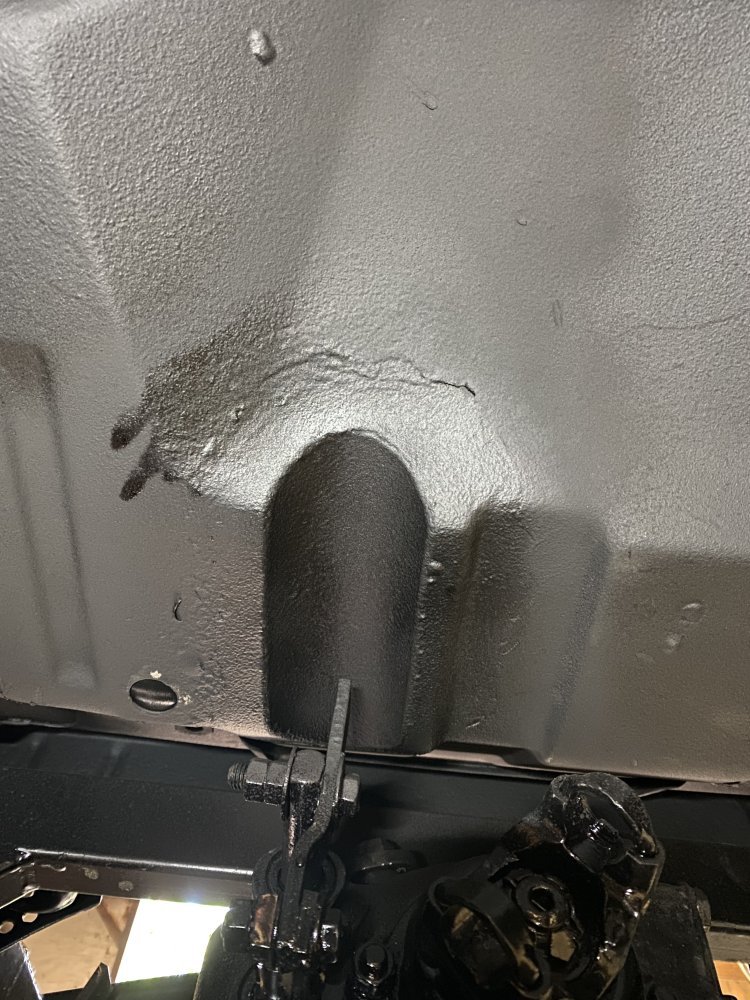

Monday I got the transfer case installed. Unfortunately the shift lever on the case hit the cab floor, so next I had to cut a hole in my freshly painted floor to make a tunnel for the lever and linkage. I made a tunnel out of a piece of 3” exhaust tubing.

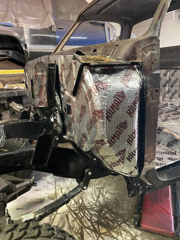

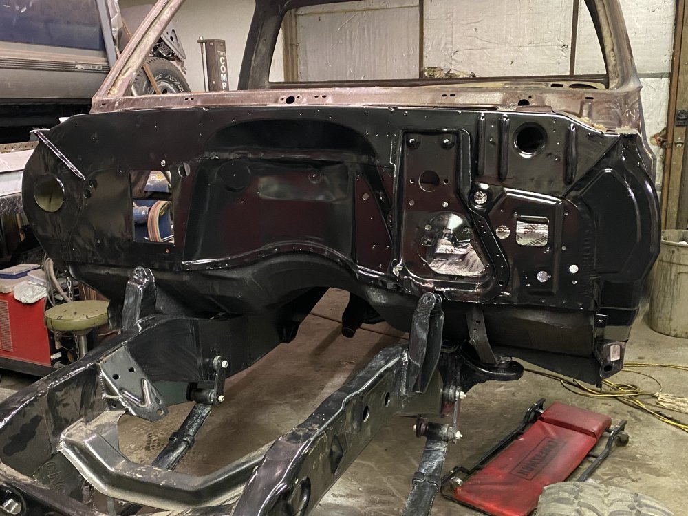

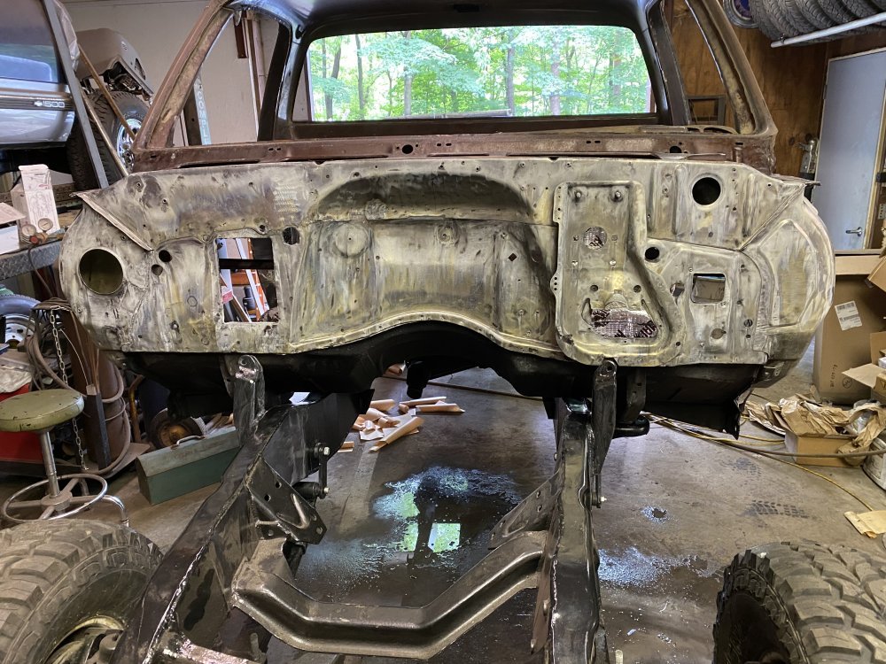

After that I moved on to cleaning up the firewall so it was ready for paint.
I put two coats of Rust Seal on the firewall and the new tunnel.

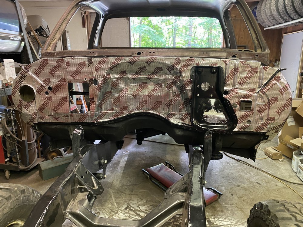

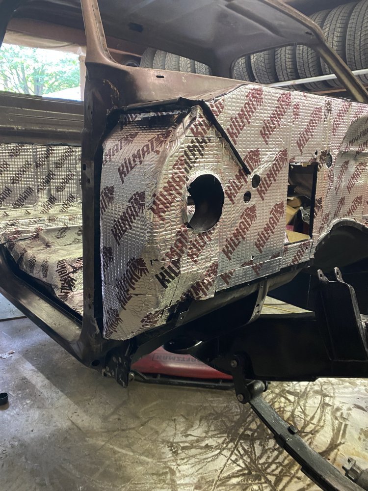

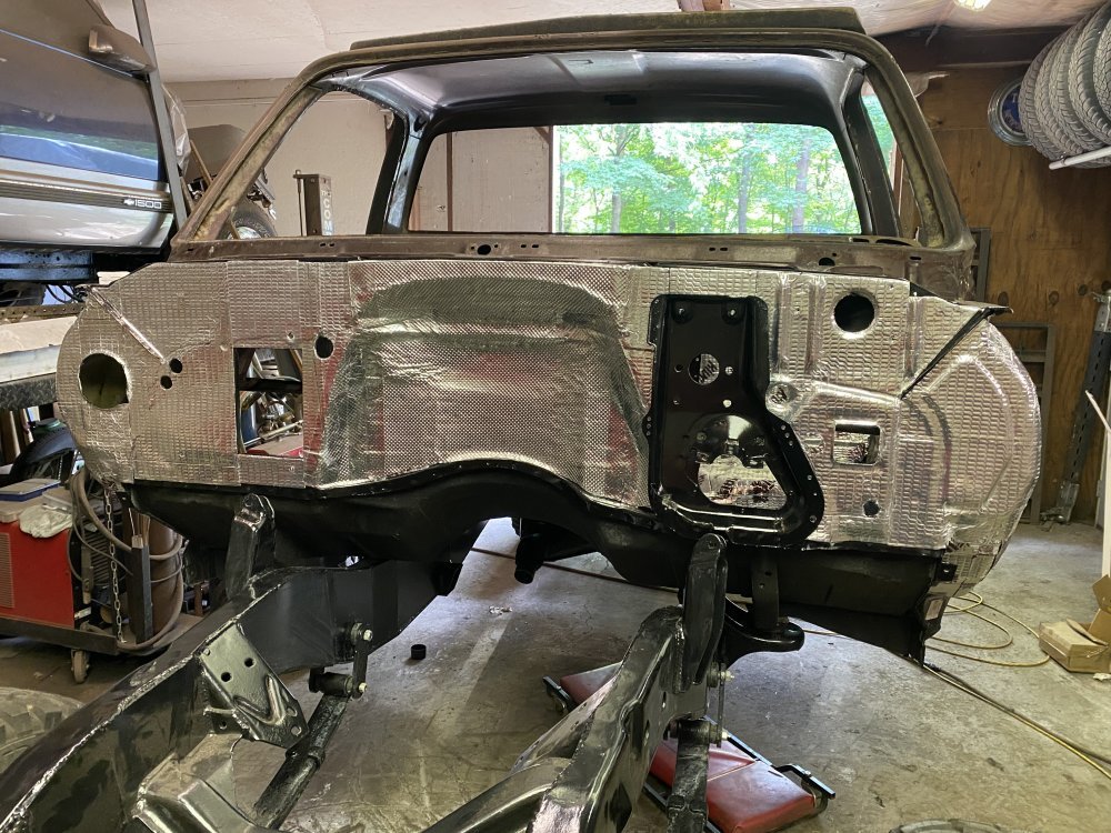

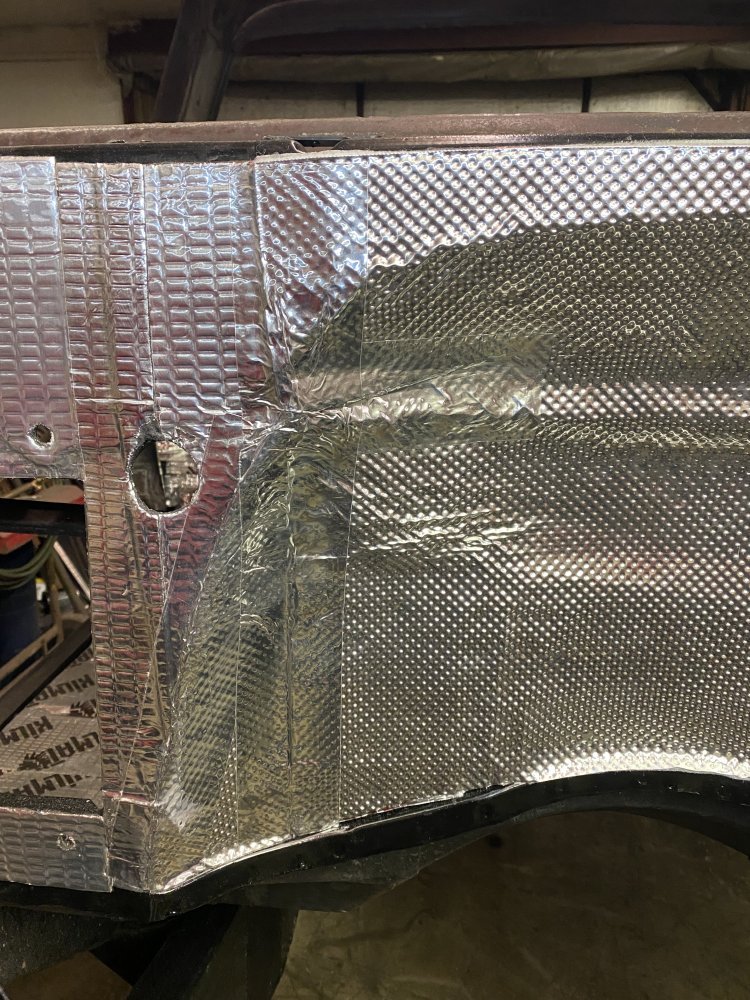

Next I decided to try something new on the firewall. My MO for my previous builds has been a full layer of DEI Tunnel Shield II on the firewall. As I was working with the Kilmat on the cab floor, I was thinking it probably does a better job of sound deadening, but I’m not sure how it would hold up to the heat…..so I came up with a plan to cover the whole firewall with Kilmat and then add a layer of Tunnel Shield II in the middle to protect it from engine heat. This seemed like a good build to try this experiment on. I was able to remove the logos with some alcohol so the firewall looked nicer.
Oh and I also reapplied some undercoating on my shifter tunnel.
Back to the aforementioned cab floor….. I think it turned out pretty well.

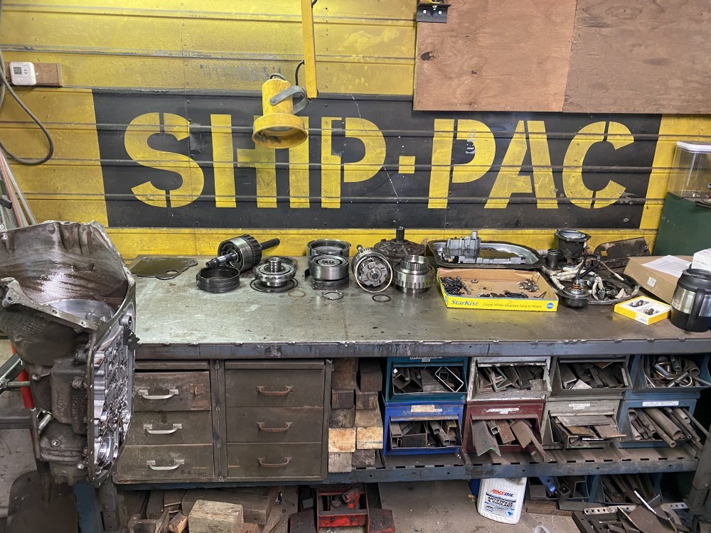

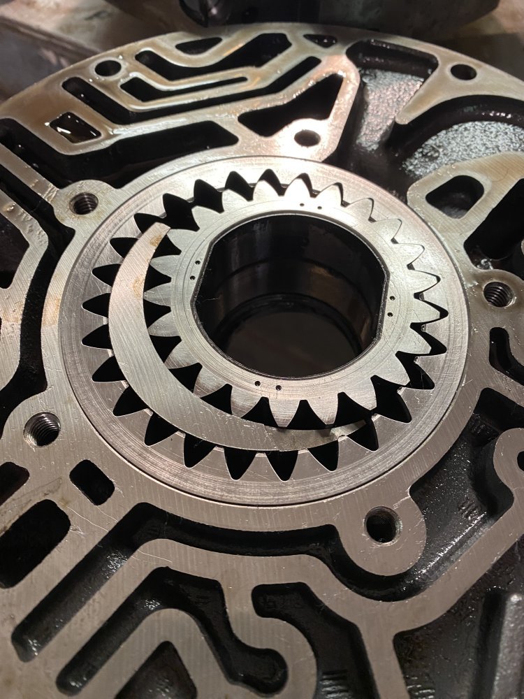

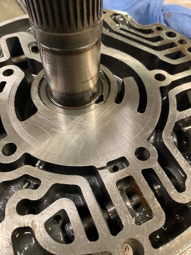

Yesterday I took the transmission apart to see what condition it was in. Fortunately the hard parts were all in good shape except for the stator side of the pump, so I’ll need to address that. This week I’m going to contact Jake’s to get a rebuild kit on order.

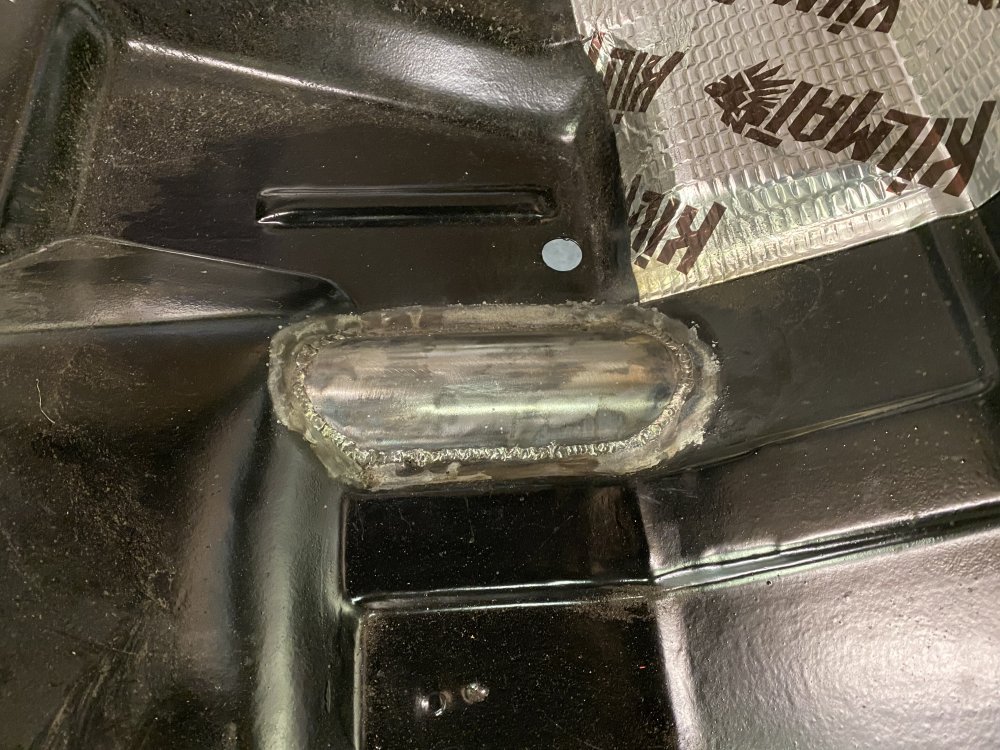

Today I fixed what should be the last of the rust on the cab. Finally.
