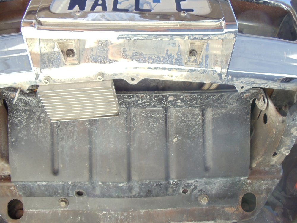

If your on a budget this might work for you. I bought this off the jungle site and the PMD lasted about two years. What I did was get the dorman resistor pack and install the resistor in the female end of the extension harness so I would never need to worry about it again. mounted the heatsink up in the drivers hole in the front pumper fins facing out and the connector pointed up. I still have the chineese PMD and it still works, but recently started getting a code for the IP timing. swapping the PMD fixed that. since it still ran fine I kept it in the glove box for a spare.

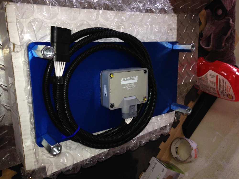

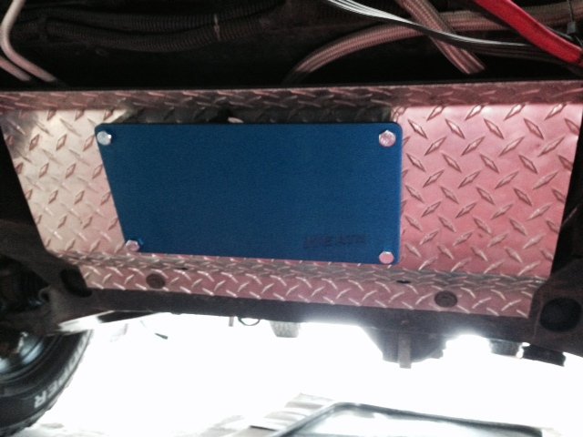

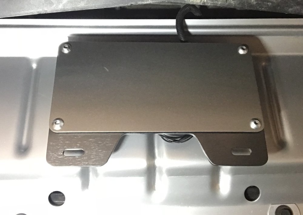

Worried it might eventually crack / split from vibrations (it did) I later replaced it with this set up from Heath Diesel before he sold the business. Unfortunately, this product has been discontinued by the new owners.
