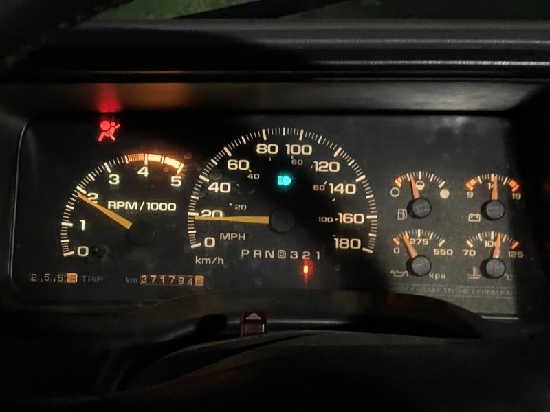

Well guys, I've been trying shake down and break in the the P400 in the Burb and here's where I'm at. I have a total of 55 miles on it and basically when I drive it I let it warm up and then try and do some wide open throttle pulls and try to watch the gauges. It's pretty hard to watch all 6 of the none OEM gauges, boost, egt, trans temp, drive pressure, IAT and fuel lift pump pressure while driving 60 to 80 MPH so I've been concentrating on the boost, EGT, drive pressure and the tailpipe via the RV mirror. I started with the timing @ 8* BTDC and then bumped the timing up 3 times so right now its set at 14* BTDC @ idle, it definitely reacted positively to advancing the timing. My last run I saw 20 lbs max boost, 22-25 lbs max drive pressure and 750-800 MAX EGT temps. It gives a little puff of black smoke when I mat the throttle from a stop but not excessive by any means so I'm thinking maybe I should richen up the boost fooler a bit. As usual I have some bad luck though, I am getting unburnt diesel fuel out probably 3 cylinders on both side of the engine. I don't think I have a compression issue because the engine starts on half a revolution and it runs great. Oh I figured I should add this when Verlin had my pump on the stand he said it was putting out 160 CCs of fuel, not sure at what RPM. The Lord was looking after me when my FR tire separated but didn't come apart and take out my fender, this is a 285/75/16 tire with only about 500 miles on it but 16 years old sitting in my garage. So until I find a new set of tires I can't drive it. Any opinions on the unburnt fuel coming out of the exhaust is appreciated.
