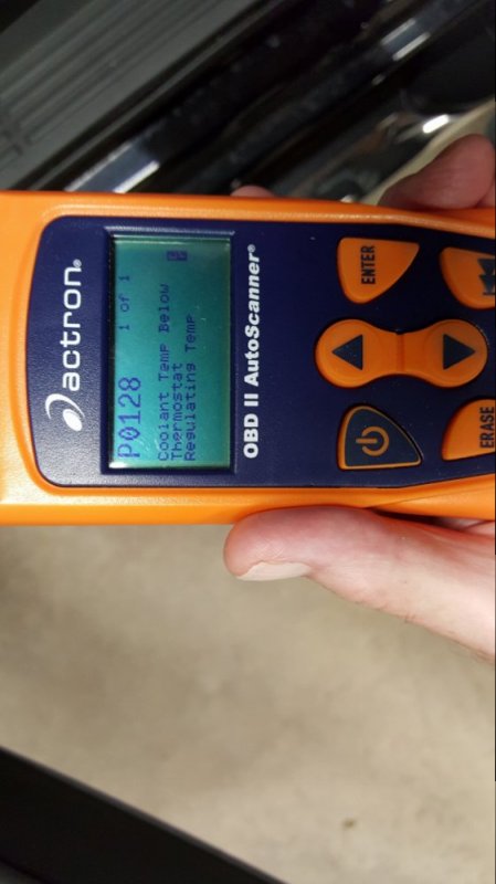

Yeah it's right there in front of me and I already know what tools will be used. Piece of cakeThe book tells you to take the belt and compressor off to change the stats. Pulling the oil fill tube out is MUCH easier to do, and no need to mess with the belt. Takes no time at all to do them really, you'll spend more time getting some coolant out than you will changing the stats.
