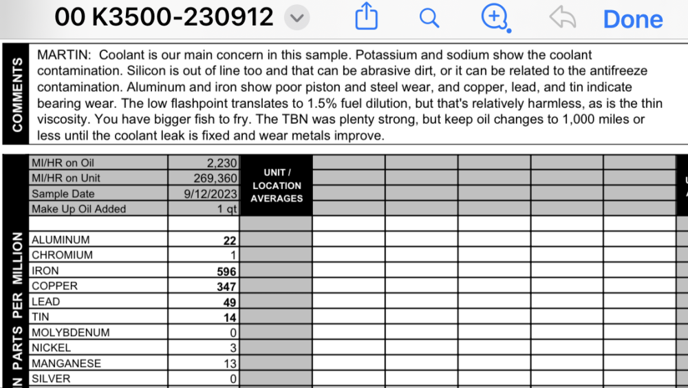

Oil Sample

Ok- GM coolant sealing tablets- have you added those yet? If not that could be worth a try.
If you drive this truck places there is no cell service- be sure you can walk from there of throw a bicycle or something in the back to comfortably get to cell service. All of y’all should know to always have drinking water and a bit of food like energy bars in the rigs at all time- the importance on that just went up here just in case. If this is a cylinder wall crack starting- it could just go all at once. The heads cracking or head gasket is more likely. Head cracks are something that when the engine cools you can drive home on- might take several cooling cycles. Head gasket can be like cylinder walls and just kill the engine all at once where it doesn’t run again.

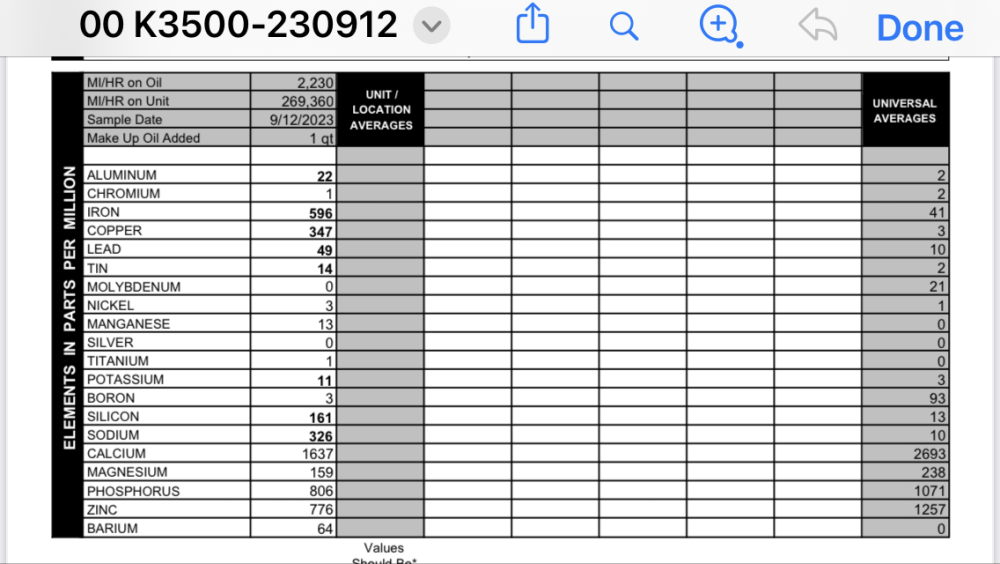

Imo this current engine being worth rebuilding is 50% at best currently.

Cracked head on Patch didn't show up in the oil samples.
Odds are very good your pulling out a Zombie.

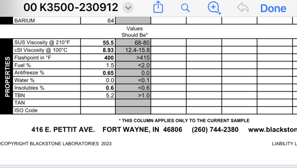

WTF for that lab? The engine oil has failed! They should have called you with "take it out of service, change engine oil immediately, and fix it". It's out of viscosity range (critical) ... and contaminated by both fuel and coolant. The high wear metals reflect this. The viscosity being low and fuel being 1.5% at this low time on oil: Well it's due for a change at 2500 miles in HD use... But it didn't make 2500 Miles. You loose oil pressure with fuel contaminated thin oil as well as the BioDiesel part of the contamination, if any, not showing up as fuel.
Cut the oil filter open and look for chunks of metal with readable part numbers. :rolleyes: More serious than kidding. You could have scored up a cam lobe.

Are you running a high % of biodiesel? This could be it alone for thin oil failure.

I can't say for the metals in the oil, but is there a chance any coolant got into the engine when you had it apart fixing the cover gaskets and messing with injectors? how long was this oil ran before and leading up to the adventure on the valve cover gaskets?
what I'm getting at is as long as your not seeing your coolant levels going down, or any different "knock" noises from the engine, drive it to get some miles on the current oil change and send another sample off to be examined. you might even send a sample now and then again just before you decide to change it again.

I asked how much coolant you have to add and your answer was basically so little coolant that I almost wouldn’t worry about it.you are not dumping a ton of coolant in there constantly. They are telling you switch to oil changes at 1,000 mile’s because you are doing a flush of the system basically.
Yea the oil in there now is bad. Yes it is showing bearing wear and all that. But 260,000 miles on this engine that we know most likely they are not good candidates for a rebuild. With the expense is takes it’s better to trashcan the GM unit and find an optimizer to put money into. So who care if the gm block blows up.

So, you had 2200 miles on the oil, what oil was this, and did you change filters, what brand filter?
The TBN is way way off from a high quality oil for only 2k miles...
On the thought of rebuild or get rid of.... Used trucks aren't cheap, the way I look at it a quality build will go 200-300k miles with proper service, if the truck itself will last it's a good investment to spend 10k on a motor... To me anyway...
And the rebuild will be what will need to be done. I’ll do the transmission while I’m at it.
Mobile Delvac 15-40. Dont remember if it is a syn oil.
I have a five gallon bucket left.
The filter is a Mobil 1 302A.
I checked the oil yesterday, 150 miles over to the cabin, the oil level is down near one pint. This engine has never used oil in such quantities. I think I better get rid of this Delvac and get back to Rotella.
I bought this Delvac after the Rotella had gone from the stores. It was still priced at the old prices so I grabbed it not knowing how long before Rotella would reappear.
Rotella is now back on the shelves so I’ll give this delvac to a guy with a truck repair shop and change the oil back to Rotella after I get home.
Take your time and exhaust the options mentioned here, baby it, change the oil as often as needed to make it last as long as possible.
I hate to hear anyone getting further into debt with the way things are going these days, your motor still runs, don't spend what you don't need to, when the time comes several on this forum have found take out motors that were in very good shape.
Yes.
I have to get the 59 Power Giants brakes back on and get that out of the shed. The step son bought a 1972 K2500, 454 with a TH400 and 205 T-Case. He asked if I could seal those two units for Him, get that done then I thnk the engine is coming out of this truck. No sense doing some of the work on it and not replace the rear main seal. Hope the cylinders can withstand a set of rings, if that no. 8 aint ate out. If main webs is cracked then cam bushes, rod bearings, gapless rings and fix the heads and back together.
Minimal to get it limping along. Hope to win a lottery, if ever I’d buy a ticket. 🤷‍♂️😹
Got home from the cabin, about 300 mile round trip.
Oil is down over a quart. Engine idles real smooth, Going to see if I can find a compression tester and see what those results brings.
What I did discover after doing a walk around inspection this morning.
From somewheres towards the front of the engine there is a major oil leak. I am suspecting front pan gasket, or, front crank shaft seal. The FCS seal was replaced not all too long ago when I installed the fluid dampener.
The oil pressure is good, about 45PSI at operating temp and on the road.
The blow by is greater than what I care to see.
This is with the CDR disconnected and the CDR blow hole plugged.
And the filler cap will lift some but also there is enough vibration that it will not set there no matter what.
And so at this time, my plan, pull the engine, drop the pan and inspect the block.
No matter what, at least cam bushes and rod bearings with gapless rings.
Tube kits in the heads, valves ground and guides refurbished. Rather they can be replaced I dont know, if not then they will get reamed, new bronze guide tubes and then those reamed to fit the valve stems.
Put it back together and runner till she blows and hope that by then there will be enough money set aside to get one of those ready to drop in units. 🤷‍♂️
Thats about the best I can do for now.
