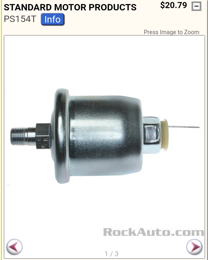

Oil pressure sender
The reason the newer ones burn out more frequently is the excessive load from the lift pump on it. Adding a relay eliminates the problem. If you are just using it for the pressure- it will last a really long time. Being smaller and more readily available- Just stick with it imo.

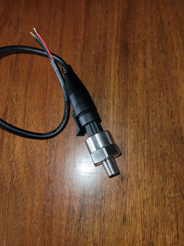

if you need OP sensor only....you must go over aftermarket spare part sensor
this is my part spare for fuel pressure sensor
it has stainless steel housing .... you can choise bolt tread, pressure range or Ohm range
whatever you need, it doesn't cost a fortune
when bought it, 3-4 years ago about $18/20 from china
you must measure your old oil pressure sender if it is in good shape....
but if you don't know how to measure Ohm ... I think it's better for you get help from someone. also to not short the sensor when you connect it.

connect the sensor to an air compressor, low pressure line with pressure tap and gauge and increase the pressure da 0 psi to 80psi meanwhile you measure with a multimeter the output signal from sender to gauge ....use a battery to power the sensor, it has 3 wire positive inlet, positive outlet, and signal to the gauge, negative pole is the sensor mass...
