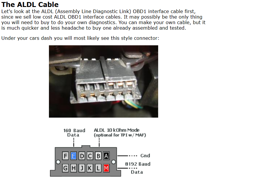

It has been forever since I messed with OBD-1, I have Engh Motors GMTD Scan OBD-1 software on an old net book, but can't find the cable.
Anybody know where I can get one beside here ? many $$$ (70+) https://aldlcables.com/products/aldl-12-pin-usb-cable , has anyone tried to make a 16 pin USB/OBD-2 work with a "16-12" pin converter cable ? Many less $$$ (16) https://www.ebay.com/itm/188335493255
