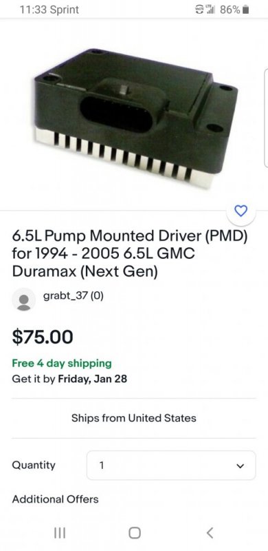

Heatsink looks under sized compared to all others I have seen. I believe the heatsink is the most beneficial element of this combination. I installed an FSD heatsink near my front bumper and I have never looked back.

Looks like a Dorman PMD attached to a small heatsink cut to the size of PMD?
The picture does not show how thick is the base mounted onto the PMD? Which is a very important to dissipate the heat.
The heatsink fin looks too thin vertically but too thick horizontally?
Fin is intended to increase the dissipation surface so the more fin horizontally and taller fin will be needed.
Of course, this is based on just the picture.
Seller is also selling Powerstroke injector?
Looks like a Dorman PMD attached to a small heatsink?
I thought about sending them a message asking if they could display a couple more pics of it.
I dont know how they would have got fins molded to it unless they just glued them on.
The fins look black in the pic; to Me that would most likely mean paint, or some other coating that might hold in heat, like a blanket of insulation.
