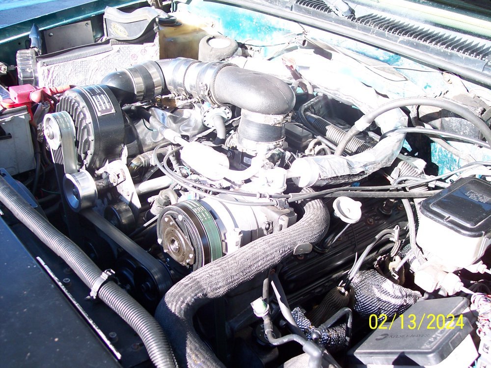

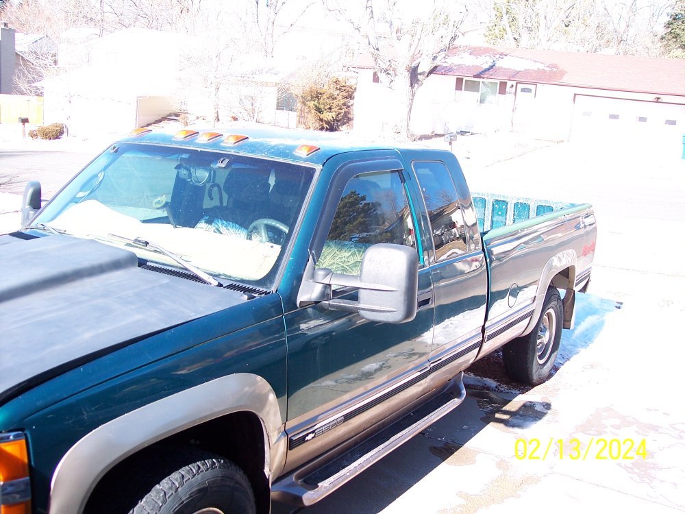

Have a 1998 K2500 CP6 option. Just installed a custom built SBC Stroker 7.0L dart block AFR heads. dyno'd at [email protected], 560ft/lbs@4Krpm torque curve is awesome ; [email protected] to [email protected] should pull future trailer with no issues except never passing a gas station. It should provide a significant upgrade from 5.7L OEM. Still going through the pains of getting a tune that runs for daily driving and towing. Black Bear Performance has been very helpful. Cold start is awesome now but still a long way to go for daily driving.
Truck is a work in progress, aka da_beest. Needs some serious TLC on body but majority of the mechanical work is completed. New stroker motor new 48lb spider and 0411 PCM upgrade and custom tune (till working on that) - from the outside looks like a 5.7L with a small super charger and headers, diff's rebuilt with 4.88 gears, Eaton Trutrac, Performance Xmission rebuild with 2K stall towing converter and xnfer case rebuild. Installed a 180A alternator and wired (2/0 and 1/0 wire) for proper voltage drop to power my camper. Primary use is Hauling a Hallmark 2023 Guanella Truck Camper she is "The Beauty and da beest".
