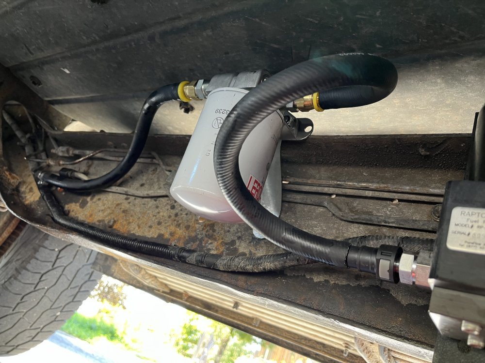

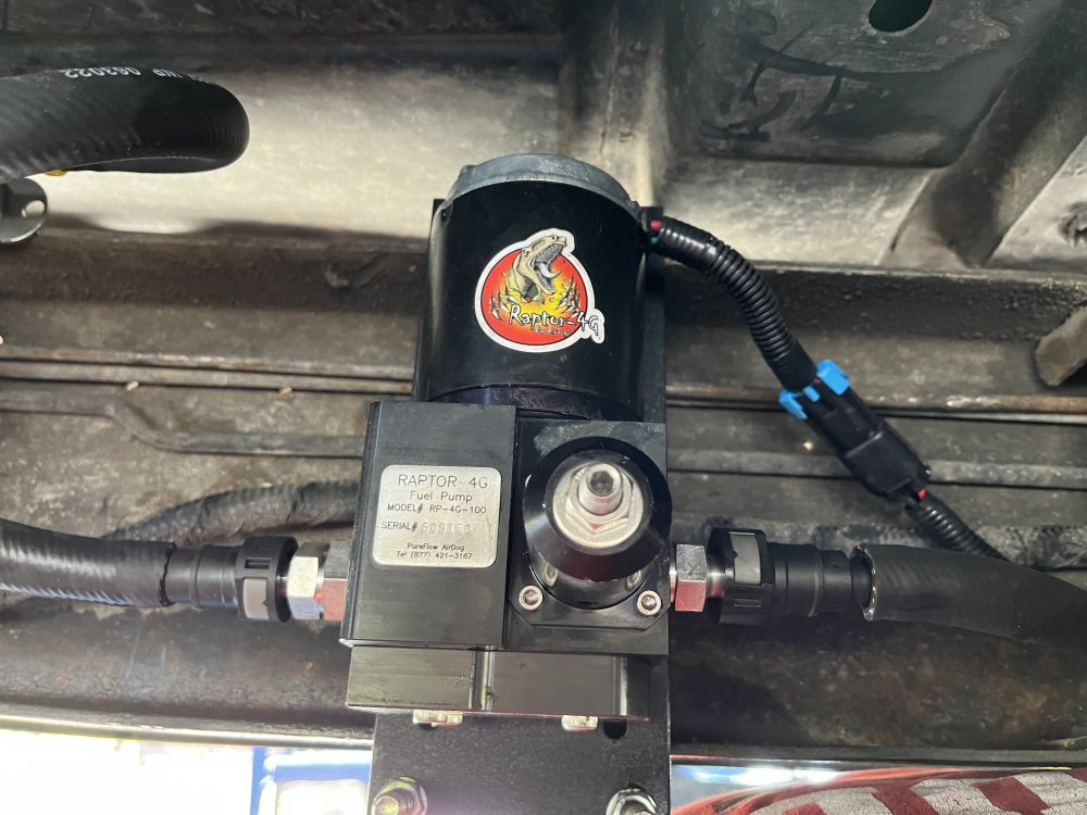

Installed the new Raptor lift pump on the ‘99 K2500 Suburban It is very quiet, like I have to crawl under the truck to hear it working.
Took it for a spin and it’s biting/stuttering badly. Got a video of the clear line and I can see periodic pulses of air:
It gets worse the higher the rpm. I checked all connections for leaks. The filter had a drip coming off it, so I torqued it down further. Took it for another spin and it’s still biting/stuttering, which is when I took the video above.
I suspect a leak in the connection of the hardline at the tank sender, similar to what I experienced on the ‘94. If I brim the tank with fuel to the top of the fuel fill, I will get fuel spilling off the top of the tank.
OK, went back at it. Fuel filter had fuel dripping off it and it was coming from the fittings. I torqued the fittings in further and the leak seemed to stop. Tightened the fitting to the rear feed hard line, but there was not much more to go there. Started the truck and the fish bite seemed to be gone. Shut it down to put steak on the grill for a reverse sear and came back to do a test drive, but now it’s not starting and I’m getting full on bubbling in the clear line with just the lift pump going (the slight whirr noise in the background).
I ordered a new fuel tank and feed line from the tank, but they won’t arrive until after I leave next weekend. I will try to drain the tank and drop it tomorrow to inspect the seals.

how far are the fittings threading into the housing. I had an issue with my fuel filter housing where the brass fittings were going in so far that the nut was bottoming on the housing. only fix for that was extra Teflon tape.

They are NPT so no seals. Not bottoming out, but tightening out.

The rain has backed off as expected, so I should be able to get on these fittings this am.
Tank is 1/2 full and when I undo the fittings, it's a constant flow of fuel coming out. I collected over a gallon in a bucket while doing the install yesterday and that includes plugging the line to the old lift pump with hose and the lock pin to a receiver hitch shoved in. I'm wonder if jacking up the front of the truck would stop the flow?

If you Jack it high enough that the area is higher than the tank

Did some damage shopping in Missoula while letting the rain pass. Got all the filter fittings and plugs taped up, installed and no leaks (jacking it up stopped the flow from the tank). I got one rough light of the engine, then died. Still getting massive air bubbles through the clear return line. Wondering if I need to tape the fitting to the hard line on both sides of this set-up?
