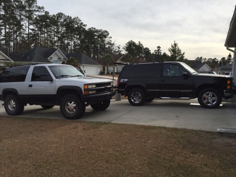

Well it's has a pretty bad oil leak and I am guess it's the rear main seal because the whole bottom of the oil pan and also tranny is covered in oil. The interior is all the but it's ruff. I already fixed the rear tailgate from not opening and fixed the rear glass above it so it now closes and locks. The truck actually drives really good but from driving it I can tell she needs an alignment.she is sitting on 35s and she is a really nice looking truck. No rust anywhere on her.Guys is it hard to rebuild a rear end?
View attachment 47116 The Tahoe 5.7 is the one that needs the rear end.
