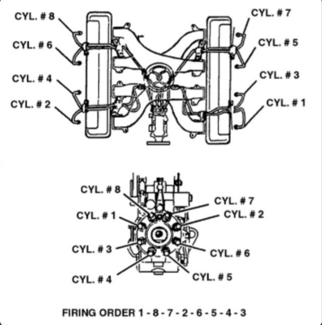

If the old steel lines are not bent and twisted out of shape, and, they align well with the nipples on tue positions where they belong, and they do not leak then I would just run with the originals.Marty you the man. I was looking all over for that info, you read my mind. Might as well put new steel lines on huh? Even though the old one look Ok. Thanks again
