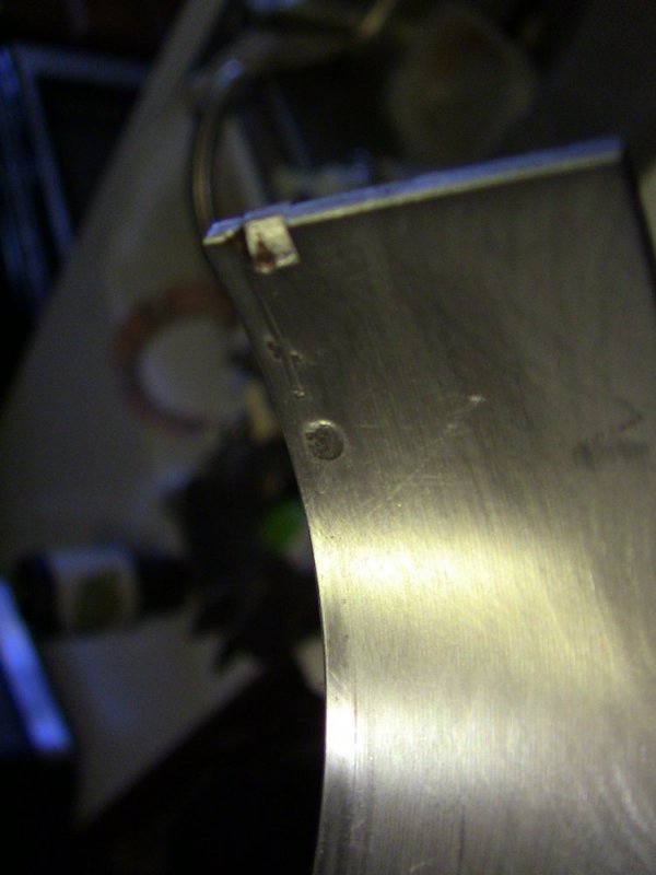

While disassembling one of the p400's I found this, going to require new rod bearings, and these motors are 'select fit" bearings.. this motor has 2 different bearing halves in each rod...001.JPG
Scoring on one bearing or the wrong clearances? I see the defect on the bearing shell.

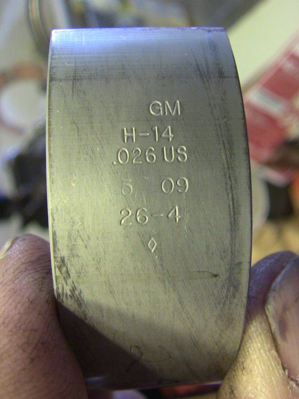

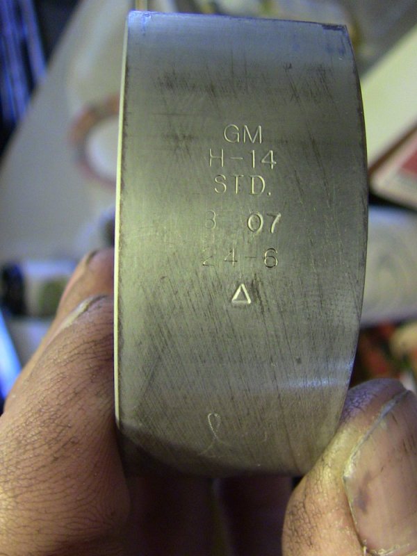

Are the middle #s date stamps? 5 09 vs 8 07?

The defect is the first pic, something embedded into the bearing, I can catch a finger nail on it and their is a score line in the bearing, only on that bearing half, not on the mate and nothing on the crank journal..
The pics of the backs are just showing how to tell what half was used to fit everything, the mains are select fit also... this is true with ALL 6.x motors...
A standard size half mixed with a 26 thousandths under for the other half? For one rod? Jeez what a mess.

Wow, and I have always been to the thinking that if there is a .026 bearing on the one side, there should be a .026 bearing on the opposite side.
That just does not make circumferential sense to Me to mix them like that.
The terms of fitting all bearings to the exact clearance size is originally “blueprinting” later more appropriately named “clearancing”.
Bearings are not perectly round. Crankshaft is. Adjusting the clearance by using different size bearings is not just common, it is the only affordable way to get the clearance to the optimum fit. The idea that a huge fat bearing on top and tiny skinny bearing on bottom seems to be a recipe for disaster. The truth is the slight difference between them is far less than the flex of a crankshaft or flex of the block even.

If you have a varience say where a bearing needs a 100 top and 0 bottom to get the gap between the bearing and the crankshaft that is optimum, yes you would be better to replace them both with a 50. However the next journal of the crank now may need a net result of 20, so you now need a couple 10 bearings. What about the next journal that need a 35? Or a 37? You basically need a complete setnof bearings in every size available to accomplish this, so since 5 main caps, with 10 sizes you need 50 sets of main bearings. Rod bearing- 8x 10 so you need 80 sets of rod bearings to rebuild your engine.
Now this is real, and engine buliding shops have a massive inventory on hand to deal with it when they are repeatedly building blue printed engines. Not to those numbers and variety obviously, but you get the idea.
Even when you spend the money and have a block line bored and cut the crank, the skillset of the machinist to get it as close as possible almost always results in the need to use different bearing sizes to gain optimum fit. Deciding to pay $700 on top of the normal price of boring the mains to get them all hand finished to as exaclting a fit as possible is up to you to decide it’s worth it. But if doing that, it isn’t worth it unless after having the crank turned, you pay the extra $2,000 to hand polish the crank to exact sizing. Which of course leads to another $2,000 for the rod big end. Now, you can have the same exact bearings top& bottom front to back and achieve perfect clearance. Btw that was iirc the actual price I paid doing a 400 cid sbc back in the 90’s. I convinced myself it would really make a difference since the big boys in racing were doing it at the time. Nowdays you can talk to most any of the builders at the track on topfuelers and they just mismatch the bearings, within as close a range as possible. So put the cost and difference into perspective.

Another thing is that .026 may be the mm size, not in inches. .026 in mm is .010 in inches iirc. So they may have had a batch of cranks that were .005 under size after finishing. Instead of scrapping them or trying to turn them furthur(they would have to go to .020 because there is no way you could turn them and polish them .005), they just used a standard in top, and the 1st undersize in the bottom to achieve a .005 undersize. I've seen this done in other engines.
Good thought, but it is actually 0.001". Putting a 1 thou bearing on one side would be adjusting clearance by a half thou. It seems very likely this is what is going on. Good - that they are checking clearances this accurately. Bad - that there is imbedded crap in the bearing.
Just went and did the conversion, and you're right, it's .001, so a .0005 change.
