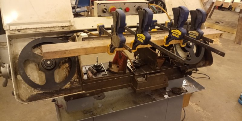

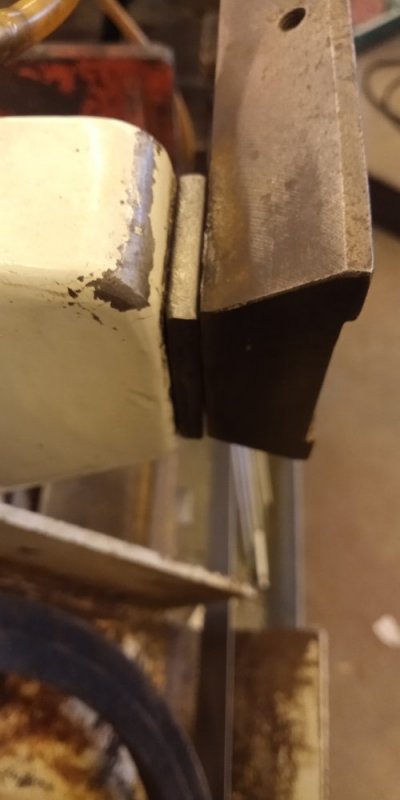

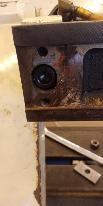

So in the process of checking things outmore I discovered that the bar that holds the guide arms wasn't parallel with the bed, which also means the entire arm assembly wasn't either. Looked at it pretty closely and couldn't find a way to adjust that. So I decided to try and shim the bar parallel. To start with I had to remove the graduated scale on the front of it. When I got that off, it was riveted on the ends as well as glued, I discovered that there was some adjustments there as well. Any ways I made a 3/16" shim and put that on but it wasn't quite enough. So I ended up making a 1/4" one. I was really pleased with the results. Everything seems to be falling into place now. Blade is centered in the bed slot, I was able to raise the bar a tad which helped with the arm height, and it seems to be tracking on the rear wheel better.
