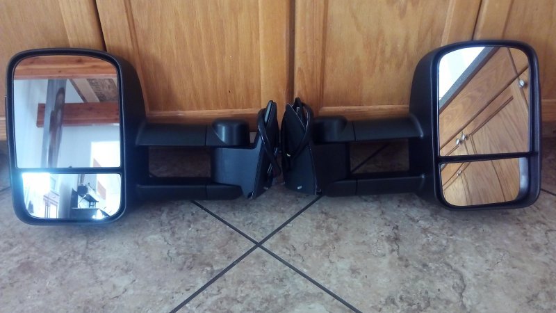

Nice mirrors Les, look like the ones I got. Where did you get them?

I found a guy on ebay that would ship them USPS. $251 to my door. I know glowshift doesn't have a very good rep but I'm looking at their dual IAT gauge.

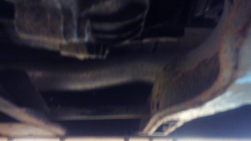

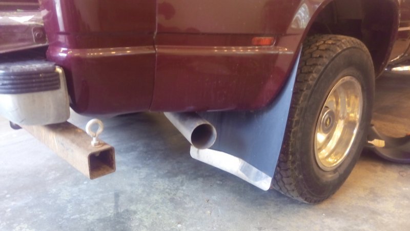

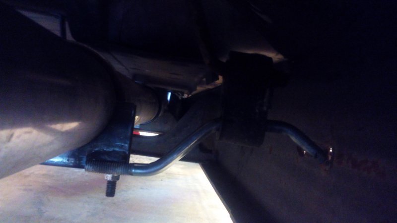

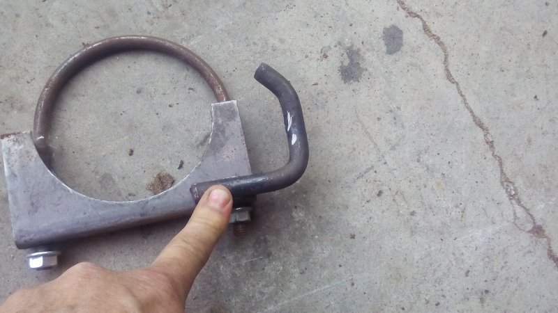

Put on a 4" exhaust today. I think it was a diamond eye system. I got it from member jamiereo (sp?) A few years ago along with a bunch of other parts after he sold his truck. Pretty good system for the most part and I wonder if my issues were from being a CC dually. First thing I noticed was the first bend or kink over the torsion bar cross member wasn't centered very good. Then the hanger in front of the muffler wasn't even close to being right and I custom made it. The very front one hit the ball and socket assy so I took it completely off. Still considering moving it back a bit and making another custom hanger to take a little weight off the turbo. Sounds good :)
Couple of pics

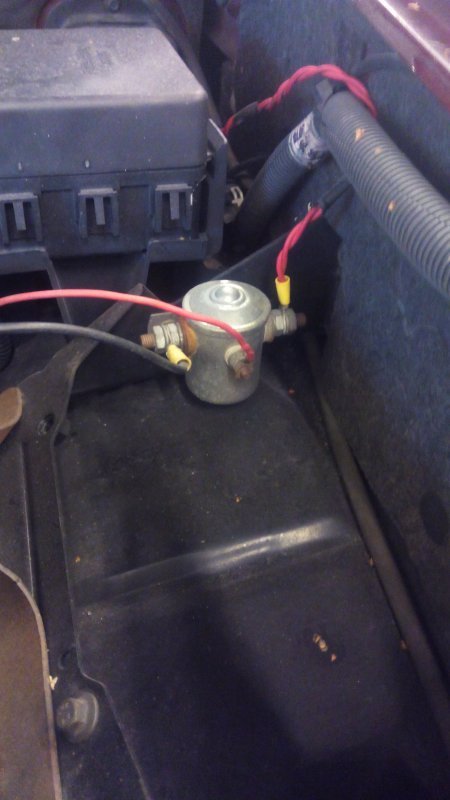

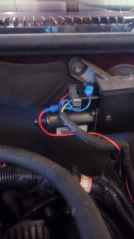

Anyone care to tell what's with this setup? Single red wire goes to wiper motor, black wire goes to the under hood fuse center and the double red wire goes to a camper plug.
Ignition on tap to prevent the camper from draining the starting batts? Solenoid turns on with the key from the wiper motor plug wire tap?
