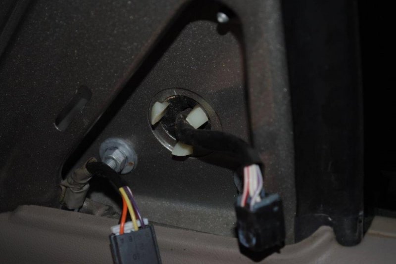

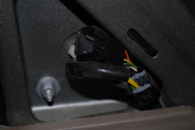

What, exactly, do I have here with this wiring? I am replacing my factory mirrors and when I took the covers off to do so tonight, I found these wire harnesses. Both are unhooked and both appear that they belong together. There is no switch inside the truck to allow me to adjust, though, if they were supposed to be power mirrors. I also have no rear defrost function, if they were to be heated to come on with that. This is in my 2001 GMC 2500HD.

It was easier for the GM to install the mirrors with the wires, even for the non functional mirror option.
Get the harness and switch to hookum up.
Is there a "how to" on this that you're aware of? Not really what I had planned for, but I might be game to have power mirrors. I had purchased manual mirrors, but can sell them if needed.
I did a quick search and did not find anything in this forum about wiring in the mirrors.
It may even be possible that the harness plug connectors might be under the dash to do a plug and play, after the switch is installed. If so, then all You would need would be the harness from that point to the switch then to the mirrors.
There may already be connectors inside of the doors, if You have the panel{s} off, a quick peek would tell.

No, the mirrors that are on it are what the original owner must have put on. By giving the VIN to the dealer, he said it came from the factory with towing mirrors. Maybe the original owner traded the towing mirrors for the paddle style. The harness that is in the door is what I assume to be present from the factory. Just seemed strange to see a harness up there and no switch to operate.
