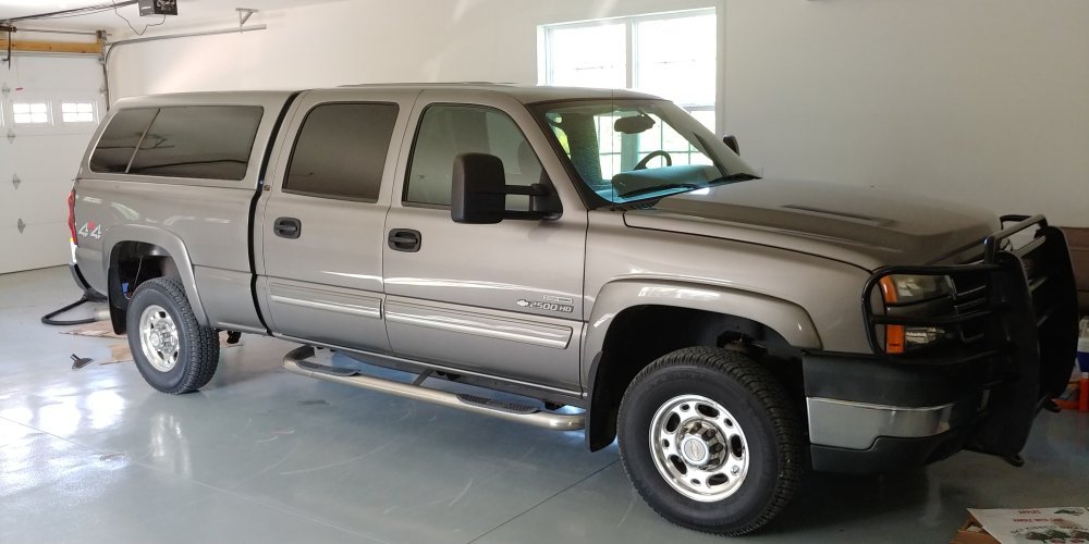

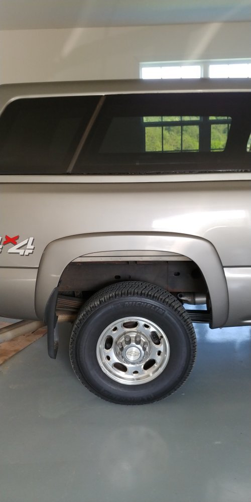

I really like Michelin tires, I have had great service out of them. No experience with the rib tires your talking about.
Right now I'm running Michelin LTX AT2's on my 2006 2500HD.

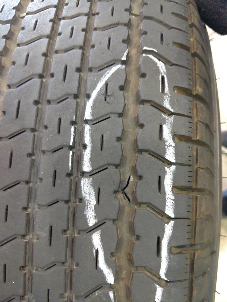

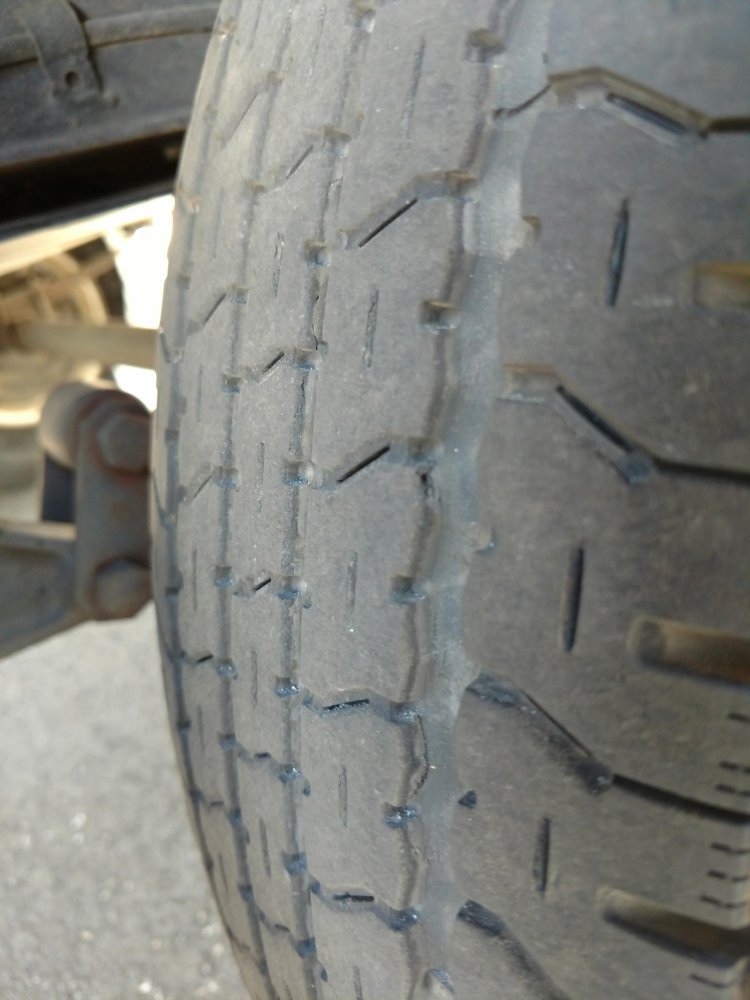

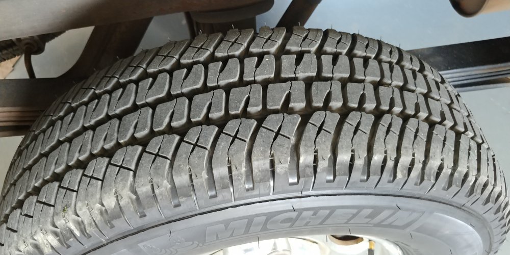

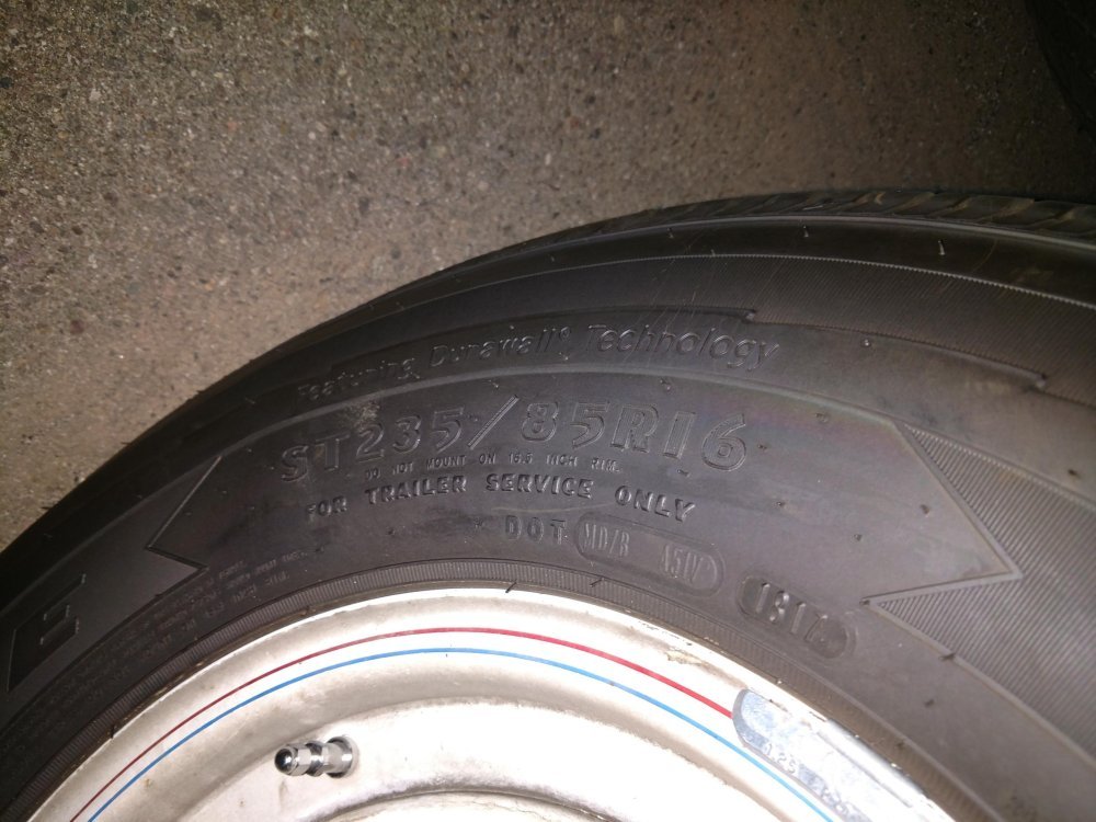

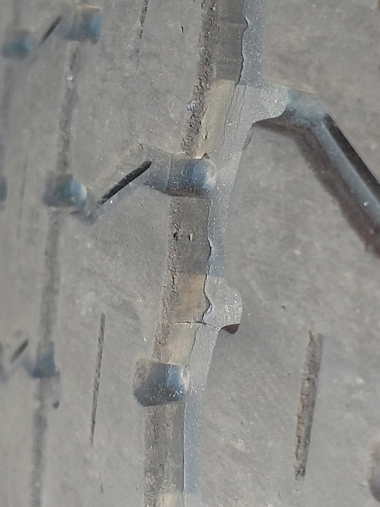

I am running XPS on my 5th wheel RV. My RV made the new Good Year Endurance ST tires cry "Uncle!" in less than a year. After good service life, 7 years, from normal Michelin LT's. The XPS RIB have the usual Michelin sidewall cracking is starting on them now. Maybe some other brands have less cracking by rumors I read. I have the scale weight of the RV and pickup: GY is NOTHING to write home about other than better than Red Commie China Bombs.
Pics of the GY ST tread cracking... And shallow tread is prone to cuts failing a tire inspection.
I would look at the inflation/weight tables and see if you can air the "steel casings" they have down like normal LT's or to at least a decent unloaded ride. If you plan on running unloaded at all.
