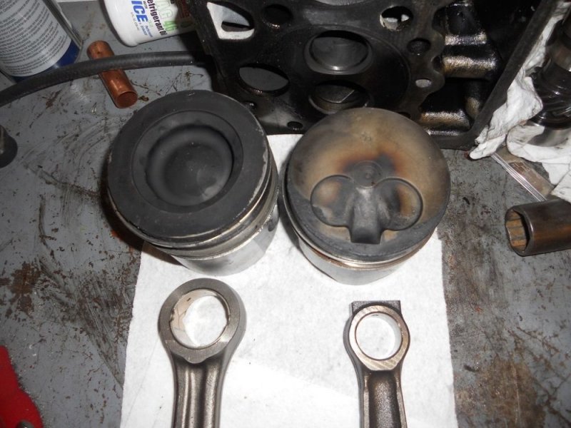

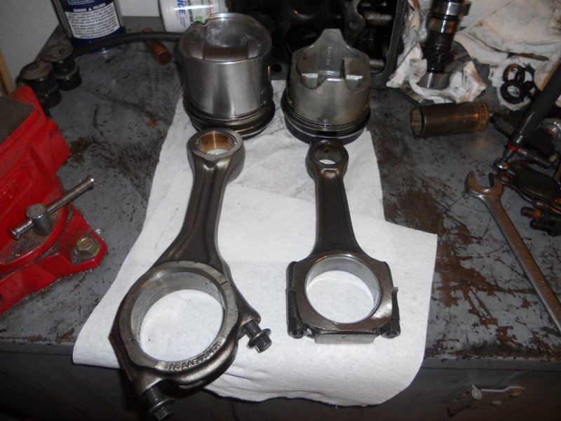

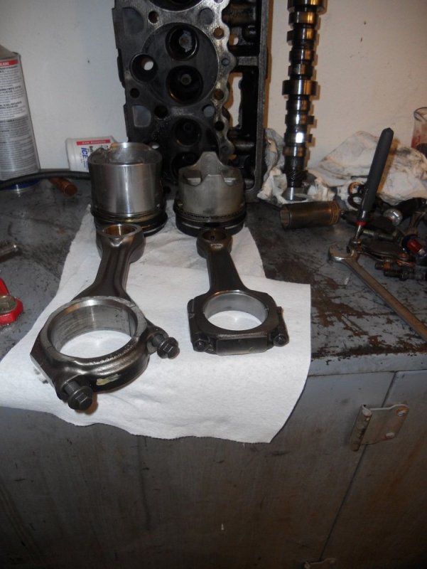

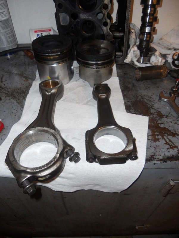

Not only that but it's a light duty diesel with Heavy Duty emissions 6.5TD vs. a Industrial Cummins 5.9 Diesel with a rated 500K miles TBO. You get 5K miles on a 6.5TD light use and 2500 Miles heavy use on the engine oil. Cummins is 15K miles or 7500 Miles extreme use. I have blown both engines and thus Gasoline engines are simply cheaper. Point of fact a 1993 pickup I am borrowing with a 454 has 180K on the original engine. (The 454 OEM power fing SUCKS over the Hot Rod 6.5 diesel I built.) My 1993 6.5 or 1995 6.5 were both on their 4th and 2nd engines at that miles. There was no rebuild or saving the original 6.5 diesel engines. The 2003 Cummins went through 3 engines at 120K: and one wasn't rebuildable.
Pictures of how Bean Counter Light Duty the 6.5 is vs an Industrial Cummins.
