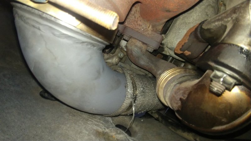

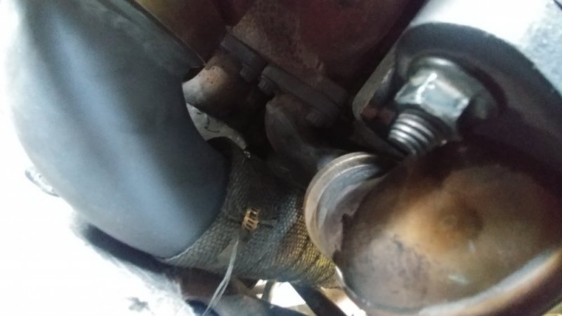

Spent almost 3 hours today, pulling out the fenders, egr blocker plate, reinstalling said plate, disconnecting the exhaust from the downpipe, adjusting the vband on the back of the turbo as it didn't look seated right, losingt the vband nut, had to walk to home depot for another one. I did everything one step at a time and fired the truck up to listen for a change and nothing. Not a damn thing helped any.
No soot around the glow plugs or fuel around injectors from what I can see.

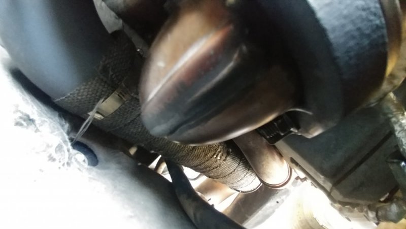

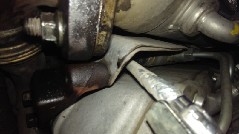

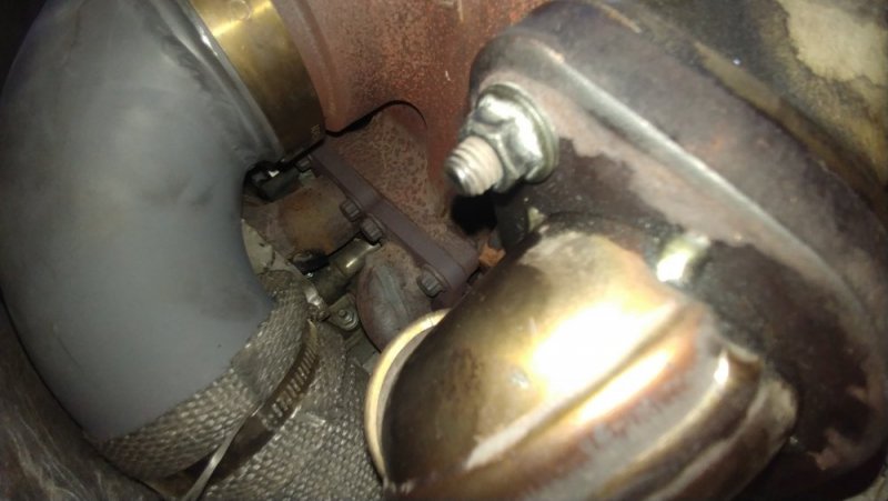

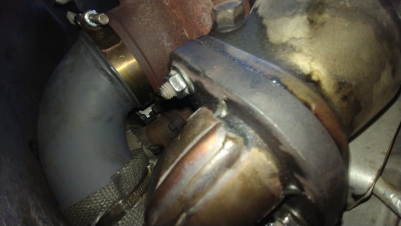

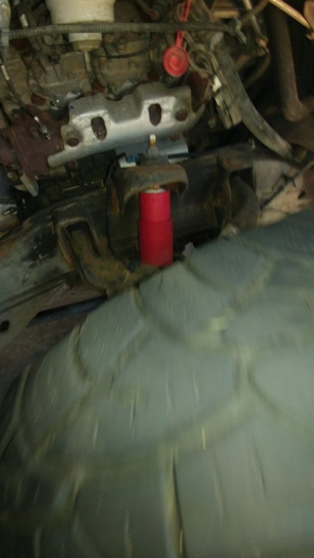

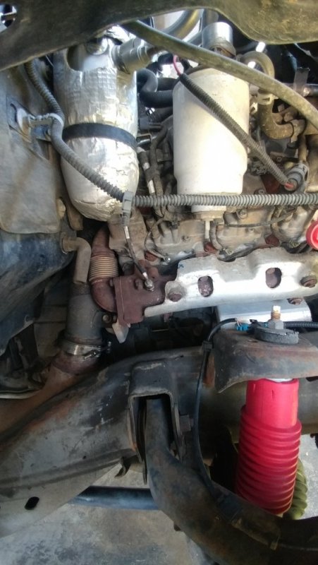

I'm at my wits end with this. No visible soot anywhere, there is a lot of what looks like oil around the egr blocker plate area. I tried firing the truck with and without the plate in. No change. I took a audio recording of the sound if anyone wants to offer their two cents on what they hear. Also snapped some shots with my phone but they don't show much1.jpg2.jpg3.jpg4.jpg5.jpg6.jpg7.jpg8.jpg

sounds like a leak right at the head to me
You thinking a head gasket?
I took the truck to my fathers, we grabbed a hose and poked around and the sound is heard most right where the downpipe meets the exhaust. That Vband is leaking bad, but, as mentioned earlier I took that apart, fired up the truck and the noise was still there so I know its not from that vband, could possibly be we were picking up the noise from right in that area though (uppipe, manifold gasket) but the leak isn't showing itself. My next step I think is to remove the downpipe and inspect that band clamp and the downpipe itself. The aftermarket one is fairly easy to get in and out.
