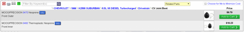

The boots on my '99 K2500 are the same size diameter for inner and outer. However, Rockauto shows different inner and outer boots by Moog:
Inner is smaller diameter and says "thermoplastic neoprene." Outer just says neoprene. They appear to be made of the same stuff. I sent the inners back and told them their site listing is incorrect.
