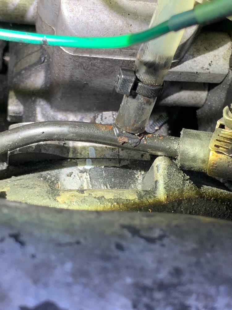

Well I decided to tweak the timing a little. Now when I push in the actuator the engine will go into a rough idle. The pic shows just how much I move the ip (top towards the passenger fender). I used a white paint marker to reference the original setting.
You should feel a little better acceleration now. Yes it was a little retarded.
I can’t tell which way you moved it in the pic. You should have bumped the top of the ip towards the driver side a little. Like 1 mm little from where you had it.

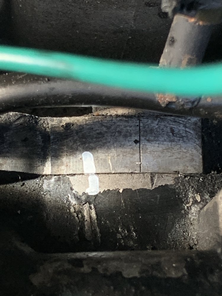

when I started messing with the IP I used a white paint marker to indicate where it was before moving anything. there is also another scribe line on both the IP and the timing cover I noticed. before I bumped it to the passenger side and this did make the engine somewhat quieter but as TSP said he thinks I made it too retarded.
Here is where I'm at now after moving the IP again as @Will L. just play with it!
I moved the IP to the drivers side and now the scribe lines are closer to each other along with my white paint mark is now aligned in the other direction towards what I think is in an advanced state. Please correct me if I am wrong here..
the engine I really can't tell if it's any quieter but seems to idle smoother now. pressing the advance lever only makes it quiet down. revving the engine I see no smoke from the tail pipe as I was getting a tiny amount before this movement on the IP.

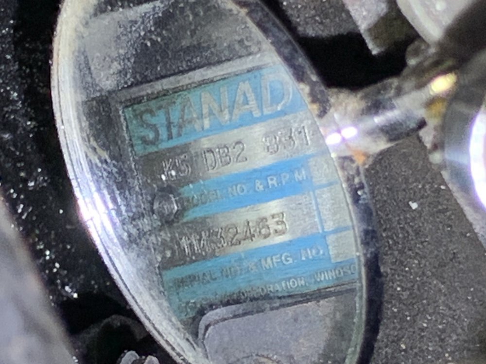

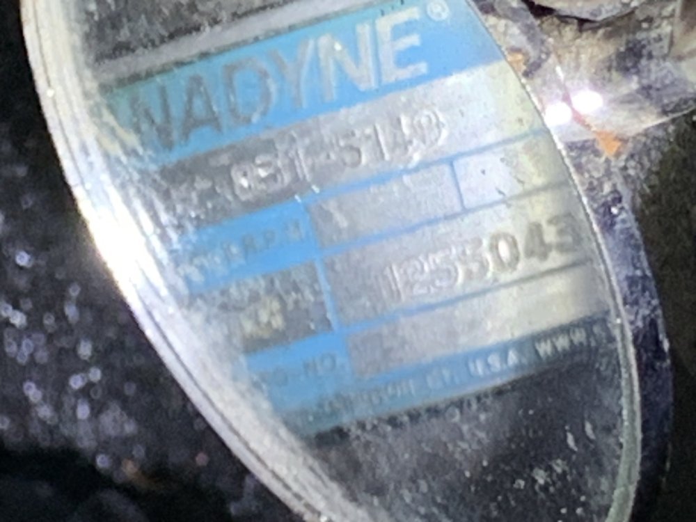

I found my inspection mirror! Yay me LOL. I immediately took it to the truck to try and get the numbers off the IP since I was told this was a military pump. below are the pics I was able to get I rotated and flipped them so there readable. There is another tag on the passenger side of the IP that looks to be hand written but it's very hard to read. This blue tag is on the drivers side. Anyone know or is able to decipher anything off this?
Here are the numbers I got...
Blue Standyne tag
K5 DB2 831-5149
12550433
1255043
11432463
