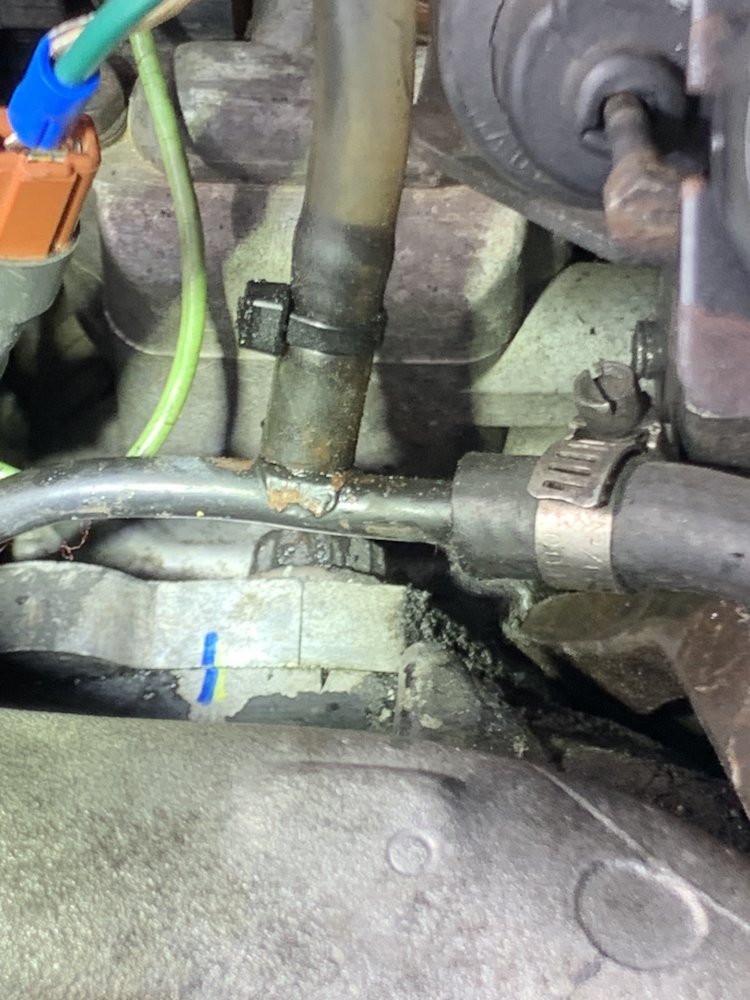

Took the truck out this evening into town, drives the same with less black smoke but it's still LOUD. when I was fixing to head out I cranked it up as it had cooled down and it was cool enough for the temp switch to turn on the idle and advance solenoids. The few minutes that was on it was extremely loud. I thing I might move the IP back some and see what it does.
Only other thing I can think that would be making the noise would be the injectors. I did some searching on the other forums and found a post from the PO that put a timeline on when the 99 engine was installed and what the mileage was then. late 2009 it was installed, the truck had about 100K on it then and I was told the engine had around 140K at that time. that was almost 15 years ago. the truck had 284k on it now which would put the engine at around 320k if the ODO is correct. Not sure when the IP was replaced though.
