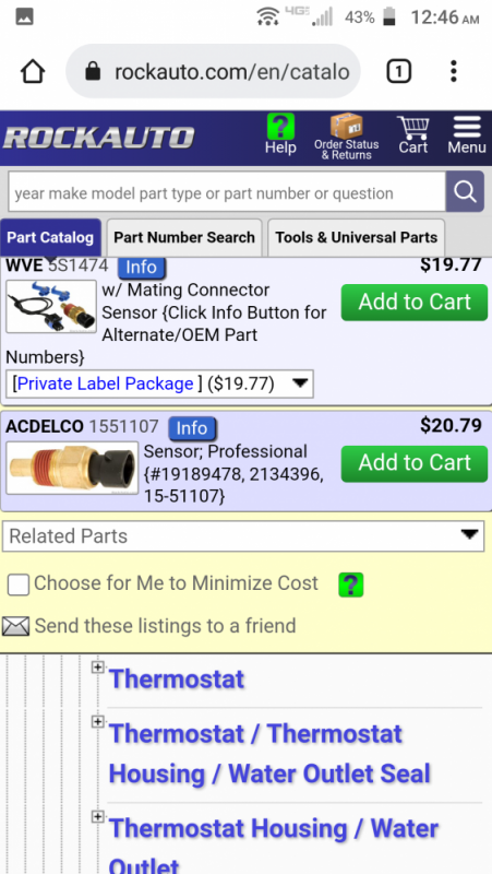

so i put some batteries back in today,. it was really tough to start,. rocked and rolled and spewed smoke no pedal input at all,. I have a 5 resistor in the pmd now. after it gets warmish? it will suddenly switch 'on' and idle nicely with no smoke. i let it idle for an hour,. then i took it for a little drive , and as soon as the temp hit 170 ish,. troubles all back again,. Todays question,. does anyone know the correct resistor value to trick the ecm to thinking its over 170? i know quadstar sells a plug in unit,. but by the time it get here its kinda expensive and i,m very poor these days. i have a bag of resistors,. it would be handy to be able to clear any codes trick it to 170f+ and then try this again,.. I haven't been able to find an ecm for a "good" price just to check see if its the problem,. My guy with the fancy scanner (snap on) says it might work if we wipe the ecm and reflash it,. ha has access to all ecm programs from gm using the trucks vin #
So does anyone know the correct resistance to use to trick the ecm temp input?

for tricking the ECT sensor, the easiest way is to ohm it out while it's at or around the temp you want. Then rig up a string of resistors totaling that reading and verify with a scanner reading data.

that a good idea,. put a sensor into the hot water on the stove and do it that way mebbe,.. quadstar sells a piece to plug in,. but the ohms are top secret,.. unless by chance there is somebody out there has one and can check it for me? To wipe the ecm and install a factory program is a exactly what i want to do,. biggest thing is truck is not insured,. or plated and won't run right as soon as it gets warm,.. with the way things are these days money wise,. i,m trying to do this on a poor boy budget,.. there seems to be little to none extra for fixing projects,. so the old girl just sits there watching the impending winter coming,..
