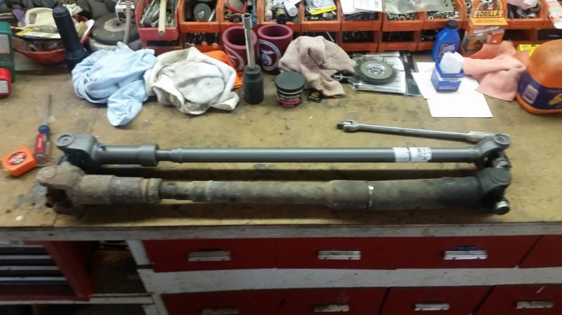

UPDATE:
How mad is the maddest you've ever been? Well that was me yesterday. I had my suspicions about the updated version of the driveshaft. I order per the vehicle specs,, and NOT of what the part looked like. Cause we all know that web sites will use the same driveshaft pic, for 33 different vehicles. Well,,, by the pic would of been better.
Turns out the driveshaft listed for the 480lE is about 2 hairs longer, that what is in my truck. $202 plus 53 core. And it's the wrong part. So since I cut out the old one,,, and now have No 4x4 here in snowy Michigan,,, and I plow a few local businesses, I'm kinda mad. SO I call the NAPA store,,, sure we got one. 35 miles away. Oh and it's $306 plus $60 core.
Freaking Awesome.
Now on the front CV axles. You just unbolt those 6 bolts on the diff housing,, undo the bit 36mm bolt, and slide it out.
^^^^^ My Ass you do!! ^^^^^ it like about 1 inch of being able to pivot out of that area,, no matter what I did,, suspension hanging,,, pressure under arm to lift it up,, heck even cussin and swearing didn't help. I dicked with that thing for and hr,, busted up 1 knuckle and smashed 1 thumb. Piss on it. I put it all back together, minus the front drive shaft, and went home. took wife and kids on road trip to go get 2nd drive shaft and dinner.
Heres a pic of what everyone that sells these things say's fit's our trucks with 480 and the one that came out of my truck,,, that looks surprisingly just like the one napa sells that says fits a 460.
today, I'll slip under truck and put the NAPA unit in. Not sure what I'll do about the CV's yet.
