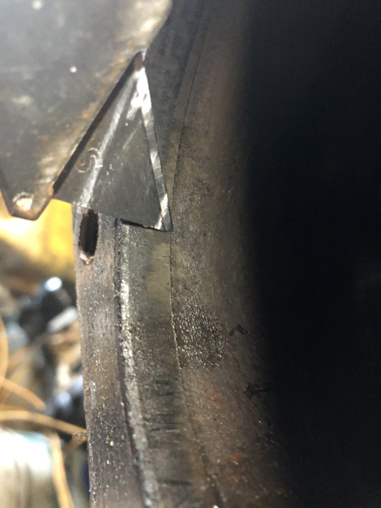

Stripped down the original engine that was in the dump truck when I purchased it. Every GM 6.5 I've owned has been a carnage candidate so I never paid much attention to the blocks, they self destructed.

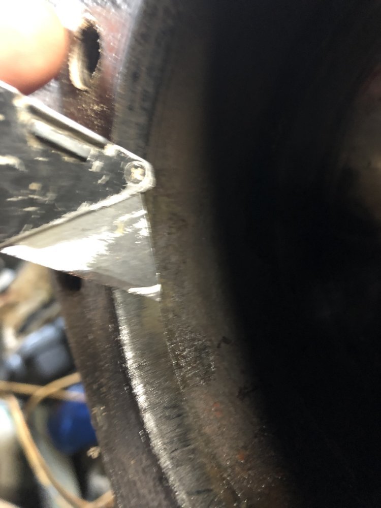

This had insane blow by when I purchased it and I knew the engine was toast, already had a takeout optimizer lined up. Seeing as how none of the mains appear to have cracks and the engine has only 130k on it, I gave the bores a look after teardown. On all cylinders, some more obvious than others, there's a lip near the deck, I'm pointing at it in the picture with the razor knife. On this one you can feel it with your fingertip. Hence the question, is this small yet palpable lip normal, or does it really show how badly worn the cylinder is?

I was going to clean up the engine and have a friend measure the bores, but if it's not even worth doing based on the lip and amount of blow by I'll get my $3 in scrap, oversize pistons are too expensive to make this block worth anything

Yeah, that looks like the cylinder wall has something built up on it- not worn down!
It is normal to have the top ring be smaller id than the cylinder because the cylinder got worn away. That looks like gobs of oil burned onto the cylinder wall and stuck somehow. Like maybe the rings were stuck against the piston so fuel burned blowing by the rings and instantly cooked the oil on the walls to it.
It is worse at the top than the bottom?
ah interesting, I didn't think about buildup like that. I'll look at the bottom of the bore tomorrow but I think it's worse at the top. Even with all that blow by you think there could be a slight chance the bores are in stock spec? that would be wild

Set of gapless rings good heads and it could be on it's way patched for cheap. Yes the machine work gets expensive along with new OS parts. Than you look at wear in the rest of the engine.
