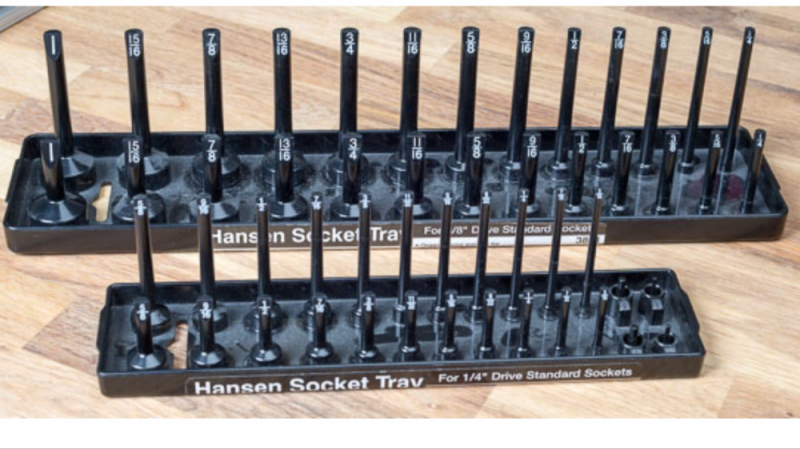

Still the best socket organizer for tool box or cart imo is this:
They fit chrome or impact, 1/4,3/8,1/2, you can see the socket size easily and clean up easy- but plastic so dont use brake cleaner. The tiny ones will break, but super glue back on.
