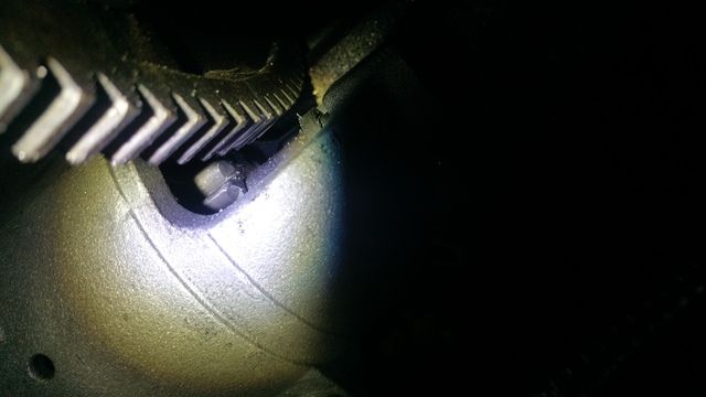

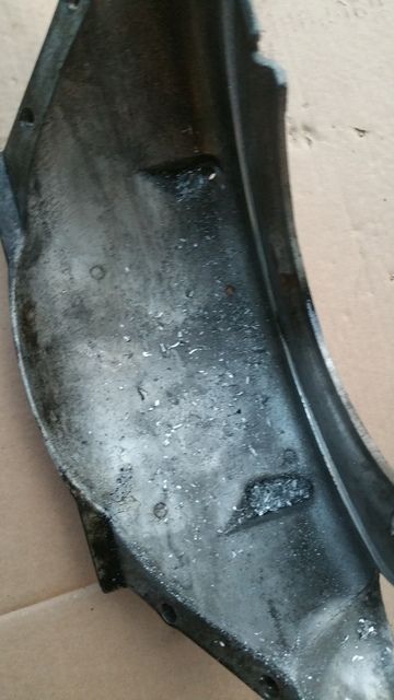

Here are some pictures.

Previously if the starter was making some screeching sort of noise, it was too tight into the starter ring and did need the shims. That is a possibility why there would be steel dust inside the cover.
Shims are installed by loosening the inner bolt, next to fly wheel then removing the outer bolt, then the shims are slid in between the block and starter and the bolt installed and other bolt secured, then it is a try it out, if it still sounds abnormal then more shims is needed.

@MrMarty51 Shims are for "other" engines. The 6.2 and 6.5 starters have "No Shim" cast on the housing so don't use them on this engine. As the OP noted the support bracket was loose likely the cause. That bracket and the special starter bolts align the starter. I would suggest replacing the starter bolts as they may be damaged - after all the 10 HP starter is known to bust the mount ear clean off the block. If you think you need a shim something else is wrong perhaps a junk reman starter or other mentioned items.

This is where the TC bolt came loose on me.
The metal shavings were from the bolt hitting the starter. All the shavings were from the starter.With all those metal shavings I'd seriously consider a new flex plate.
