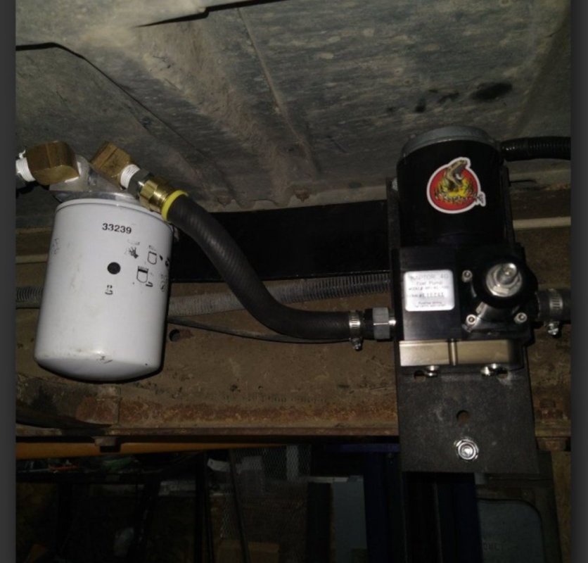

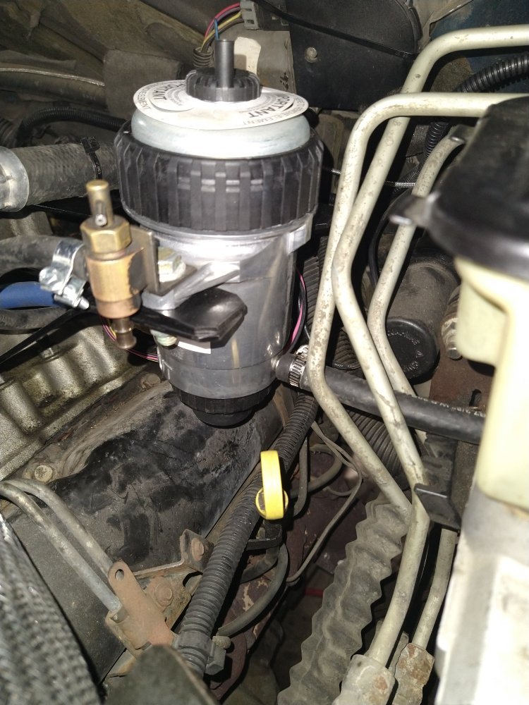

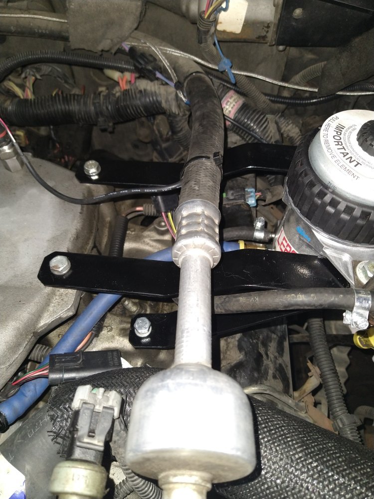

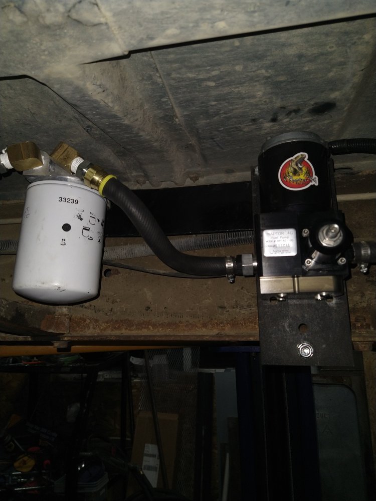

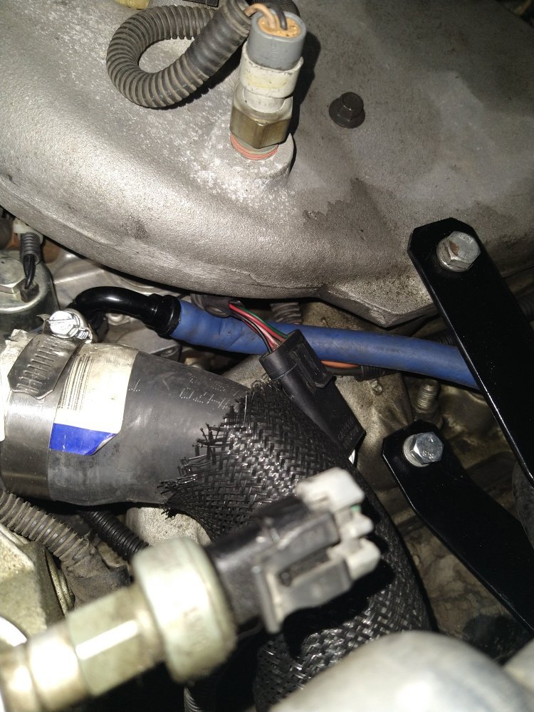

I attached some pictures of the recent Raptor fuel pump and FTB filter install. I relocated the filter to make it easier to get at.

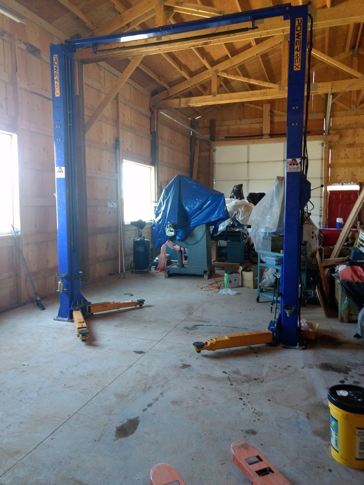

Roy UT is easy enough. Sure a lot shorter than driving to Omak WA.
The shop sounds great. Do I guess correctly you might be a Forged in Fire kinda person? Pneumatic weaponry is great stuff. Don't need to worry so much about backstops and it really all falls down to proper hold, breathing and trigger pull. Caliber is insignificant except for that kick thing.
The relocation of the T-Valve to the FFM is an interesting concept I haven't seen before...I like it. I just got rid of it and the FFM with the AirDog.
Please don't hesitate to send your number. I'm sure between your skills, my dumb luck and the help of my life line it'll all get sorted out. I have an extra ECM that while tuned for my truck's turbo and cam etc, also has the vacuum delete and boost control limits removed so we can at least try it out and see if the defueling sorts out.
Yeah, I'm a tinkerer, and love doing things with my hands. One of my major hobbies is refurbishing old Garden tractors. I have about 12 right now... most run, but many need some work... keeps me out of the pool halls I tell my wife, whose very supportive and patient.
Some of my pneumatics have the same ballistics as a 45 ACP, and same caliber... they've been used to take deer and wild hogs, etc.
I actually studied Diesel Technology in college, along with Manufacturing Engineering Tech. Spent a few years as an Ordnance officer in the Army, where I got to play with tanks and similar items...
I'll be retiring from the Defense Contract Management Agency (DCMA) at the end of this month... Exciting, but scary...

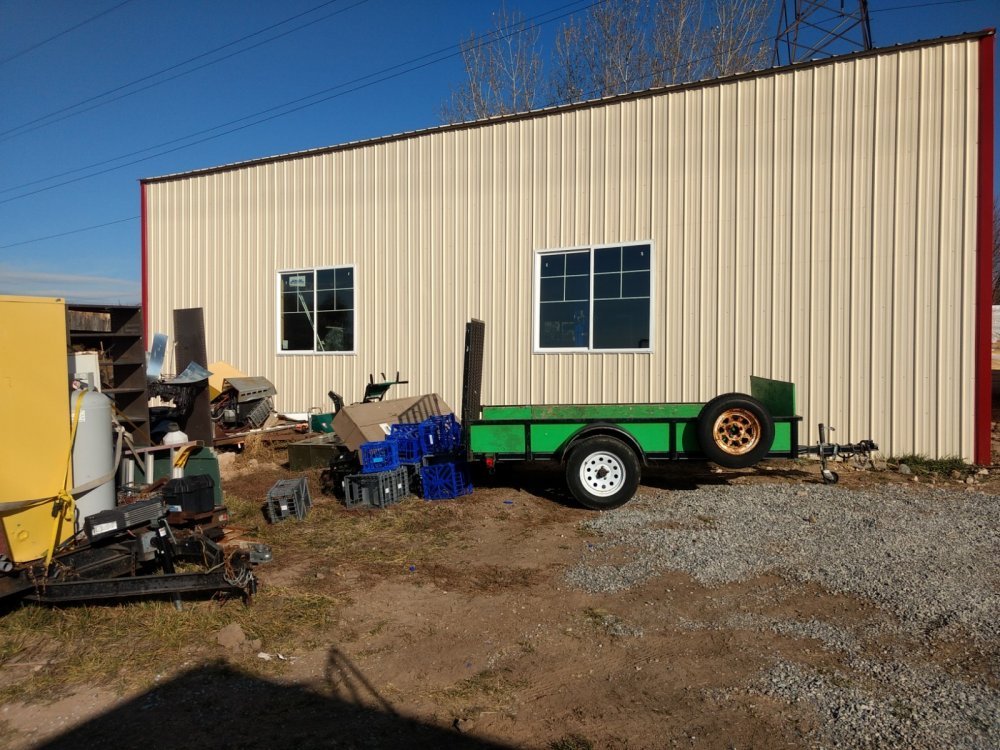

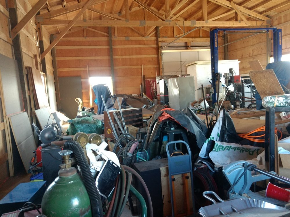

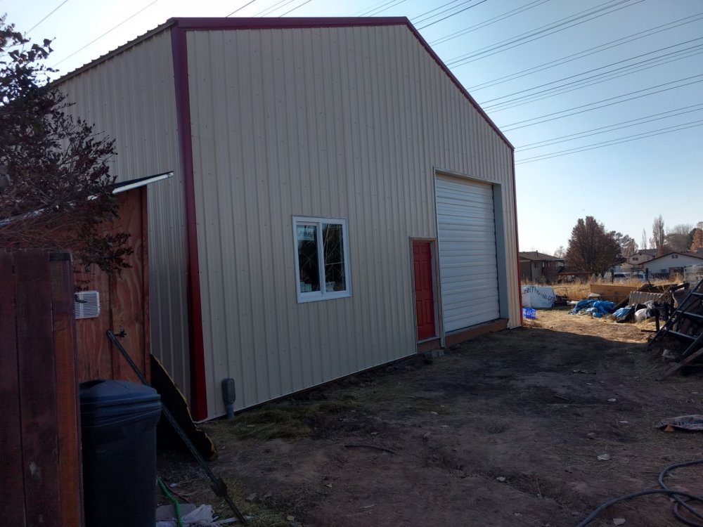

Anyway, I'll get to work on things so we can work without having to walk around things. I've attached a few pictures from when we were first building it-- about 4 years ago.

Utah Smitty, that's a wonderful Man Cave ya got there. Got your contact info. Next Friday or Saturday, 13-14 SEP 24, works great for me. Wife has plans for me so I can pick the day, just have to leave her one.

Is this filter pre LP ?
Yes, it's between the tank and the Raptor pump. I got both the Raptor pump and prefilter through Leroy diesel. You'll also get a length of 1/2" ID fuel hose and an adapter to hook it to the sending unit of the tank. I'd recommend replacing the sending unit when you do this as you'll want to remove the fuel strainer on the tank side of the pickup tube, so you'll have to remove the sending unit anway.
I also installed a Feed the Beast fuel filter which allows increased fuel flow into the final filter (located at back of engine) and into the injection pump. I choose to relocate the final filter as it's a pain to access at the back of the engine, and a major pain to reconnect the fuel fittings, etc. I used the same fuel return lines from the pump, but ran 1/2 hose from the Raptor filter to the engine bay, then necked it down to 3/8, which is what the FTB final filter uses. You can see it in some of my previous pictures.
I just used 1 1/4 x 3/16" flat bar and bent two pieces to raise the filter about 2 inches, mounting one end on the top of the air intake, and the other on the ears of the filter. I also made one brace to keep it from bounding around... I used an existing threaded hole (8mm) on the intake manifold and the other end to the front bolt on the filter. This is quite rigid and doesn't vibrate or shake. Total length of flat bar needed is about 32"--get 36" to be safe.
You'll want to get a 90 degree fitting for the injection pump vs the black135 degree fitting used if you keep the pump in the orginal location. This will make it much easier to fit the push lock fittings onto the hose.

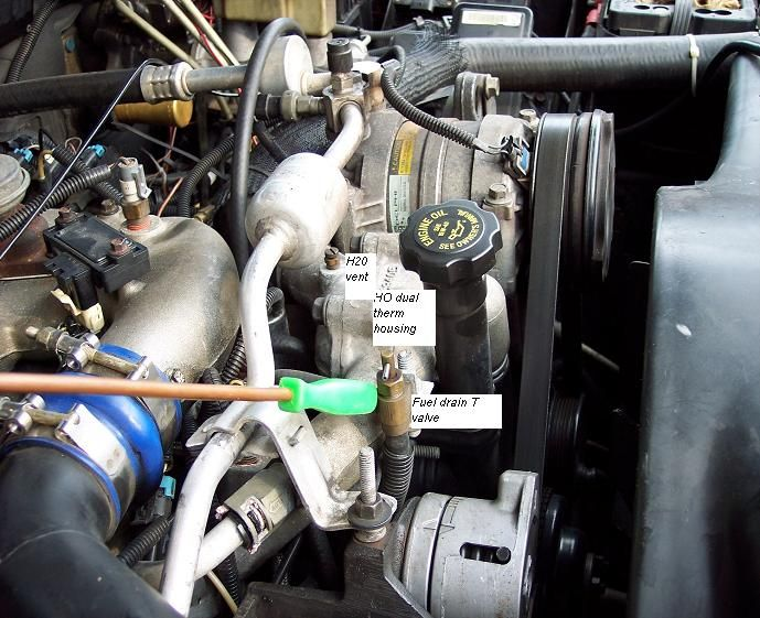

I mounted the fuel drain on the side of the fuel filter, but routed the hose over the valve cover to the front of the engine so it's not dangling over a hot manifold. When I drain it, I'll merely pull the hose out, put a suitable container under it, and open the valve.
Hope this helps.
