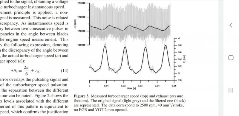

A drone is a frequency of pressure pulses. What if it has something to do with the stock 6.5 turbo exhaust system. It's the only v8 diesel with a side mount open system. The length between each bank to the turbo is different. And on top of that the drivers bank runs into the rear two cylinders on the passenger side. So the frequency of the pressure pulses reaching the turbo is "off balanced" for a lack of a better term. Turbo speed will actually fluctuate a 1k rpm or so as these pulses run through the turbine housing. What ever happens on the exhaust side will transfer to the compressor side. Air leaving the turbo and entering the intake will have a similar "off balanced" pulse because of the changes in turbo speed. Now I would think the Intake would create it's own pressure pulse due to the opening of the intake valves. But that will be a very balanced/even event unlike the off balanced exhaust pulse. Maybe these two pressure pulses create a unwanted drone when then come in contact?
