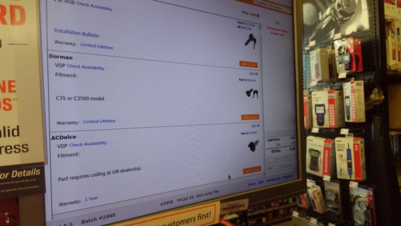

Ok so I'm confused..
I replaced I replaced my ignition switch (key switch) back about 2 years ago or more..can't remember the brand but it's not dorman and not Delco...it's another brand from auto zone... It came with new keys....don't remember why I changed it... But anyhow I'm trying to replace all my electronic stuff that's under warranty from generic parts to A/C Delco because Chevys don't do well with anything else but Delco... I ordered a new Delco switch it arrived at auto zone, but when I went to get it there was a problem... No keys to it...so looked on there computer thinking maybe there just missing from this one,
That's where it got weird.
The computer said it has to be coded by a Chevy dealer...WTF.. why would it have to be coded?? It's a 97'.... and the other brands come with keys but this one doesn't...on the bag it actually says GM part...Not Delco.. which I would think would be even better... They said they had to order it from the vendor so maybe that means GM not Delco...any thoughts on any of this?KIMG4081.JPG

Yes, it is common on many ignition and door locks to require being ‘keyed’. That way you got the factory key pattern for your rig and off just the vin number a door key can be made if you lock your keys in the car or leo wants into your car. Convinent

Ok let me ask this. When I bought the truck it had a security system in it. I think the p.o. disabled it ( I removed a bunch of stuff that went to it that was stuffed under dash and behind backseat...like I said I believe it had already been completely disabled.. does the key have anything to do with it?? I don't remember there being anything electrical so to speak on the key switch when I changed it before. But didn't know if it does anything except manualy turn a switch on and off in side...I remember guys saying they had problems with ignition switch a causing issues and since old one was under warranty anyhow and Delco one was same price I just figured I'd change it to eliminate a future issue.
The ignition lock cylinder is separate from the actual ignition switch. The lock cylinder is the keyed portion that connects to & turns the ignition switch. The theft system didn't get tied into the lock cylinder until 98 to my knowledge.
