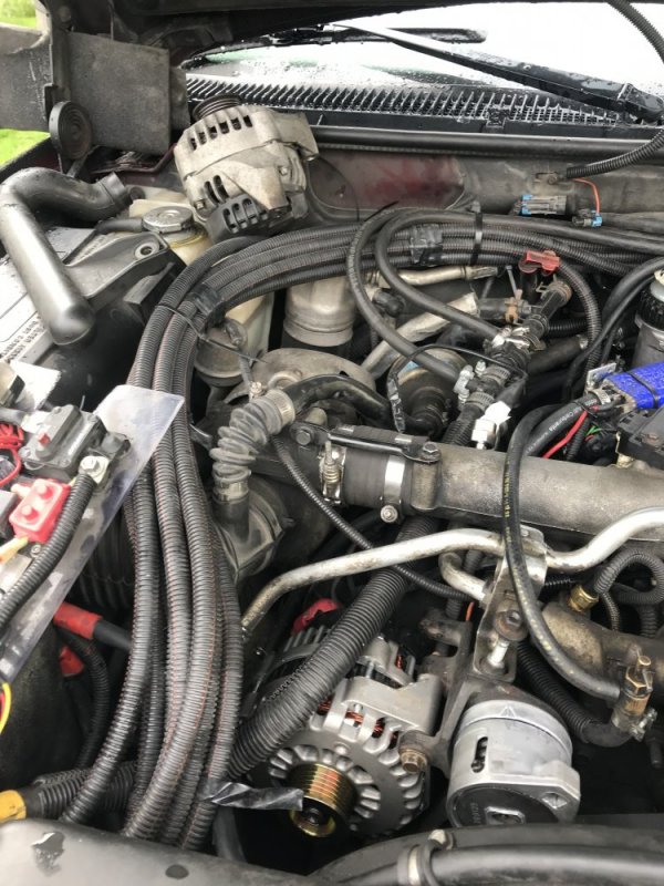

So, I went to the local shop the other day. He had an AD-244 in stock that he had marked as a 190amp. Went to pick it up, and he carried out to the counter laughing, saying "you are going to like this one" It seems he had just tested it, 175amps at an idle.... and 215 at full output.
Swap went pretty flawless. I did have to go get a longer belt, but I already had a rather tight one, from when I had to swap the fan, and outer balancer (had one explode at a year old last july!!!). And... the trip to the auto parts store netted the wrong one on the first trip. Seems someone had put the wrong one in the sleeve....
Anyway, had the chance to plow yesterday morning (about a foot of fresh snow!!). Electrical performance is MUCH MUCH better. I run a full lightbar on the roof (MX7000 5 rotator, with rear halogen flashers running) all the time while plowing. Plus, being a suburban, dual heater fans to stay warm. I was able to actually cook myself out this time!!! Even at our 8° temps outside. Amazing what happens when you can actually run the heater fans!
Plow runs much faster as well. In the end, my voltage (as reported by torque pro via obd2) never dropped below 13 except while the plow was being activated. within moments of turning off lightbar and driving off to the next driveway, the voltage would jump right back to 14. Previously, I would end up down about 11.5 - 12 volts and stay there until I drove a good 10 minutes. It was so bad I would let it idle for 15 minutes after each plowing session (end of the route) to let the batteries charge back up. Now.... its not a big deal.
I could be happier with the swap. Probably the best $275 I have spent on the truck for plowing in a LONG time!
