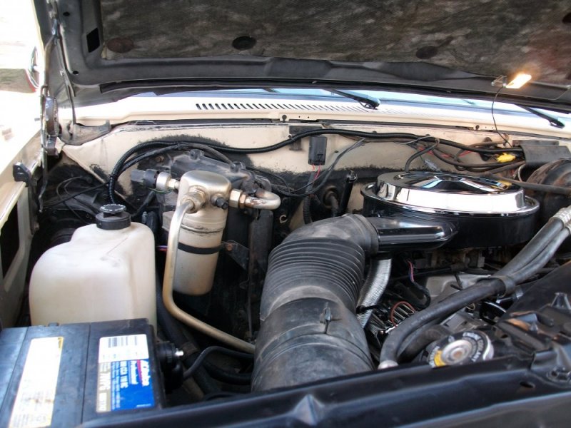

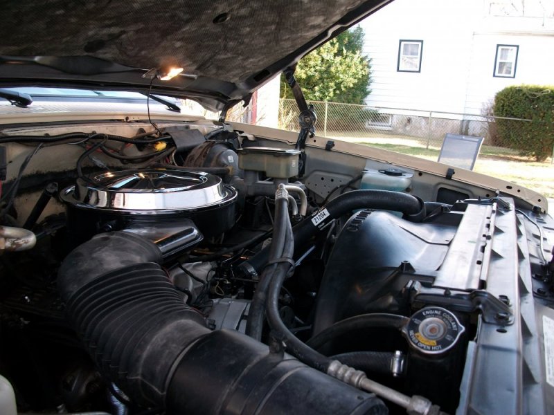

I have a 350 gas V8 and in the mornings when I start the engine, I have a slight miss until I put it in gear, then the miss-fire goes away, and the engine runs fine ? I restored the truck over the last few years and I put in a matched set of TBI injectors and an new SANY0212.JPG SANY0213.JPG Edelbrock 3407 TBI intake manifold. What should I be looking for ? I run it on 89 octane fuel and have run 3 bottles of Chevron Techton and Royal purple fuel system cleaner through it and still I have the miss.

Hay thanks for getting back, No, it just misfires in cold and once in gear there is no sign of any misfiring. I put a MSD coil on it, should I go with their cap and rotor ? OEM parts come from, hell I don't even know anymore. Thank you !
