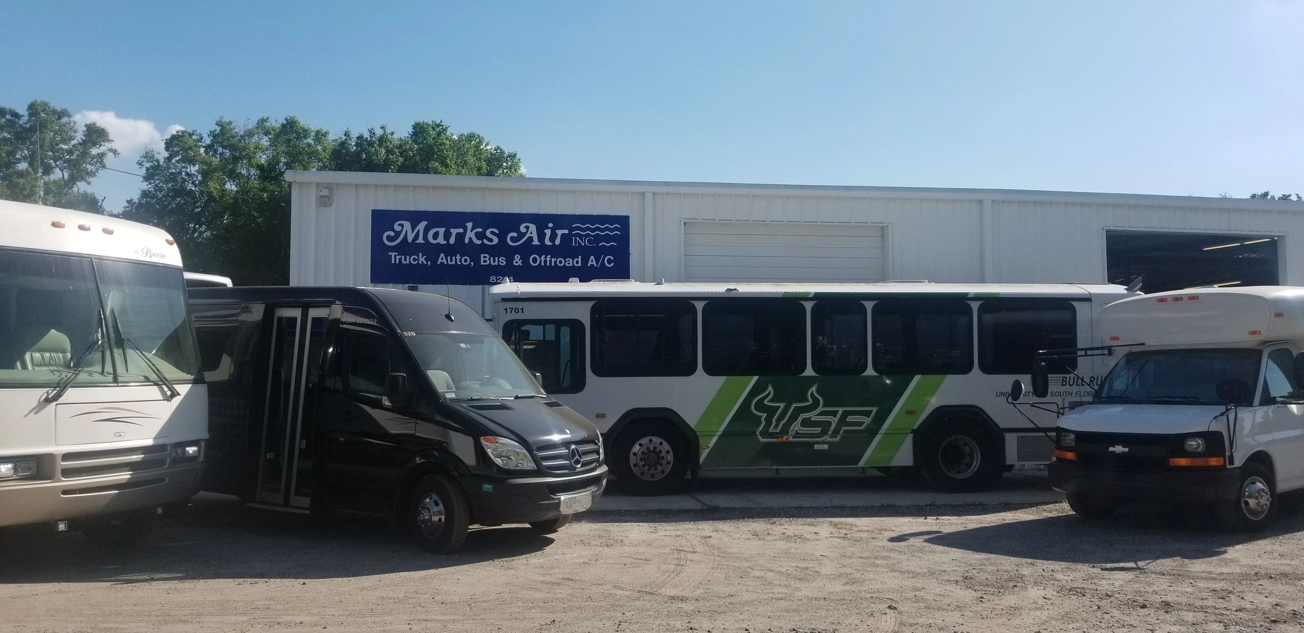

Measure how much room you have and give these guys a call. All they do is A/C work in mobile applications. They do add on's for cars, truck's, buses, farm equipment, construction, you name it, if it moves, they do it.
